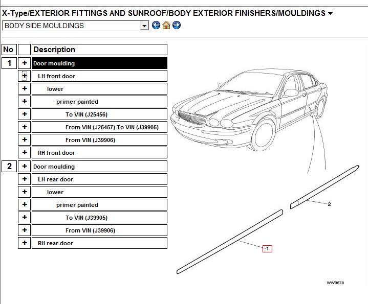

The XJ's and XK's don't use clips. The door mouldings are secured with double sided tape. I checked the Parts Catalogue and there's no clips listed for the X-Type door moulding:
Any chance the PO has been there before with an improvised fix?
Attachment 40796
Huh, weird. I guess maybe the PO did some redneck engineering. That sucks.
I pulled out the clip, looks like there was only one and it was near the end toward the rear. The first half is on securely, so I don't think I want to remove the whole strip. It starts to peel away right about in the middle, so I might just try and clean up both sides and put some double sided tape starting at the middle and all the way out to the edge. Removing the whole piece and starting from scratch would probably be easier, but I don't want to risk making things any worse.
Why the hell anyone would drill a hole in the door and put in a plastic clip is beyond me. All id did was hold the end part of the trim on. There was still a gap near the middle.
