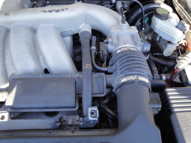

Meanwile, today I replaced that crankcase breather tube that tends to develop a breach. It runs alongside the main air intake and is now a ribbed Plastic tube rather than a smooth Rubber tube. I read the JF thread about "Cruise Control & Jerking". Here's a picture of the new one against the old one.
