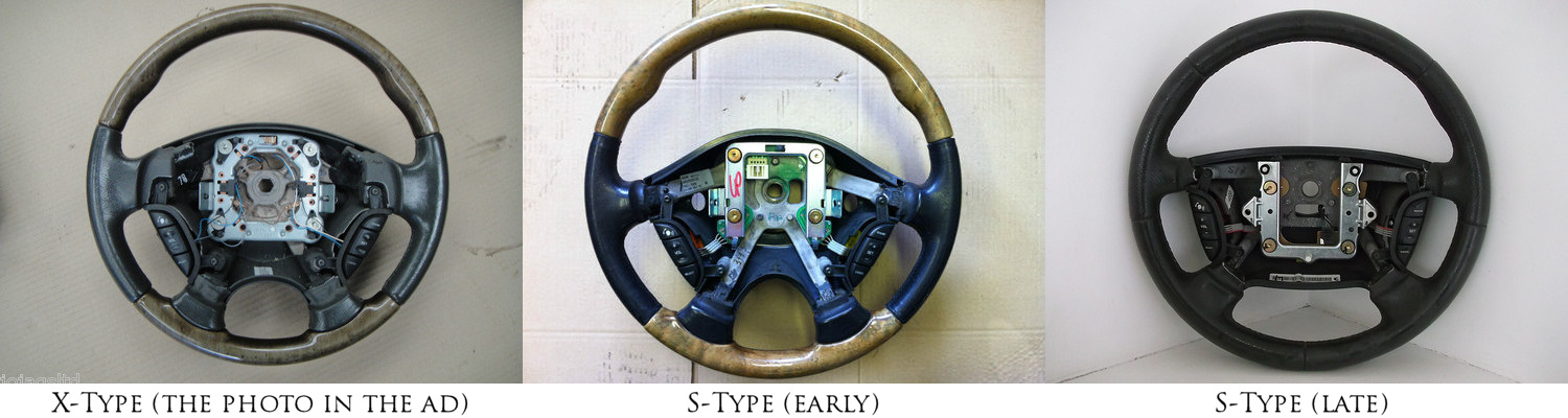

Just a quicky could anybody tell me if you can fit a Stype steering wheel into my 2001 xtype,
As ive been offered a walnut and leather wheel for £20 quid in exserlent condition, any advise welcomed
Thanks rob

The mounting hole in the middle looks different, I wouldn't try:

I see ur point think ill pass cheers for help

Hi back again the pics showing the three wheels the xtype hex hole applies to all x types? Reason I ask is think I may have found one, but as I haven't romoved my wheel yet not sure if mines hex, thx

I seem to recall reading that someones X-Type had a circular hole, but can't remember where I saw it...However, all steering wheels I've seen for sale are with a hexagonal hole, and mine are as well.

Well removed my wheel and it is hex hole so fingures crossed I may hav me a wood/leather wheel thanks again
