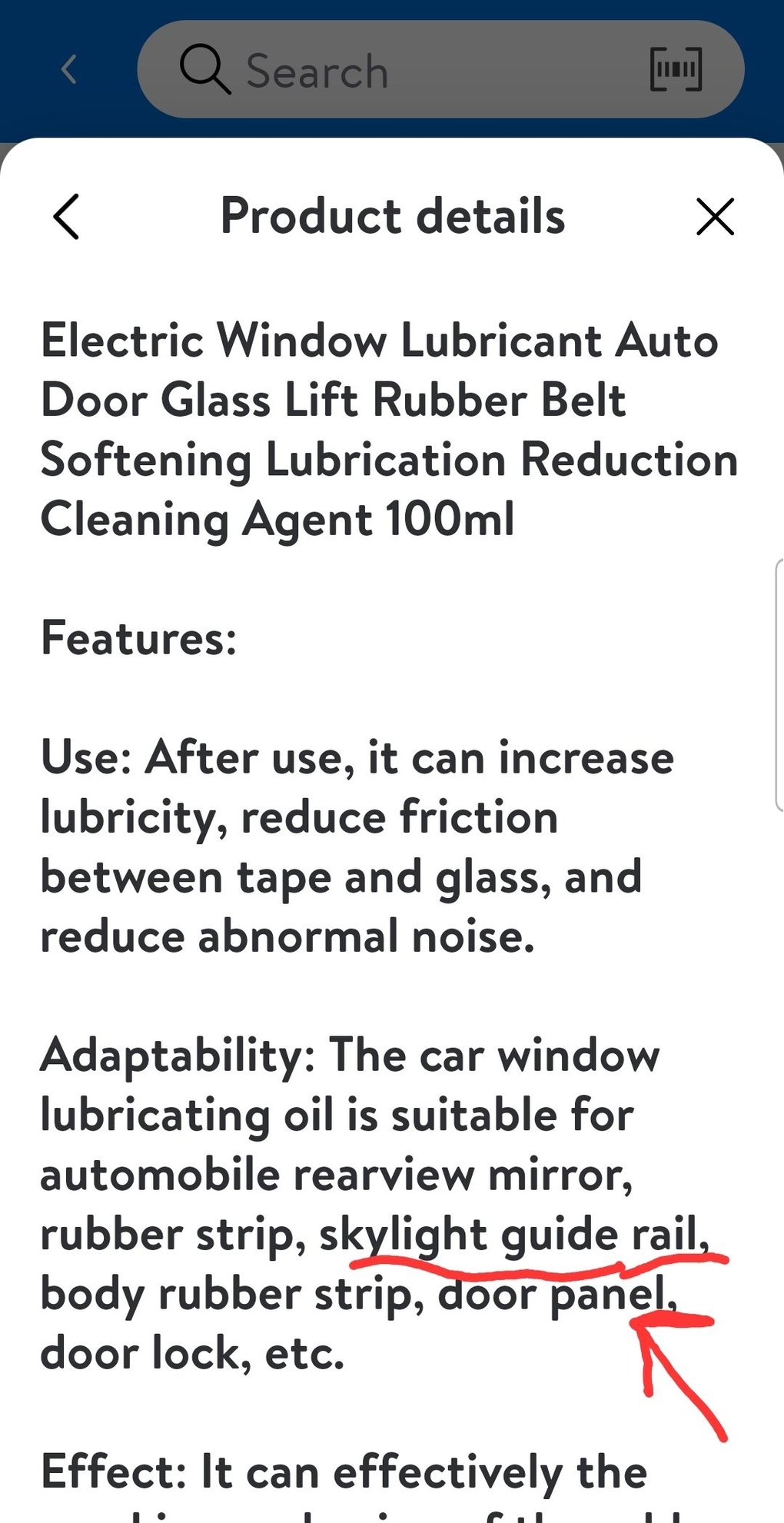

At Walmart

Any idea what the lubricant is? just Silicone maybe?
For my Renault panoramic sunroof I used lithium white grease spray on the rails to get rid of squeaks and failing to close.

Yes, it seems like the spray shown above would be for the surfaces that mate when it closes and another lubricant should be used for the rails and mechanism. Perhaps white lithium is what I should use.

Not really

Thanks! I should have read closer.
