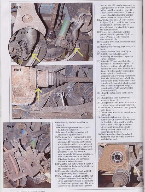

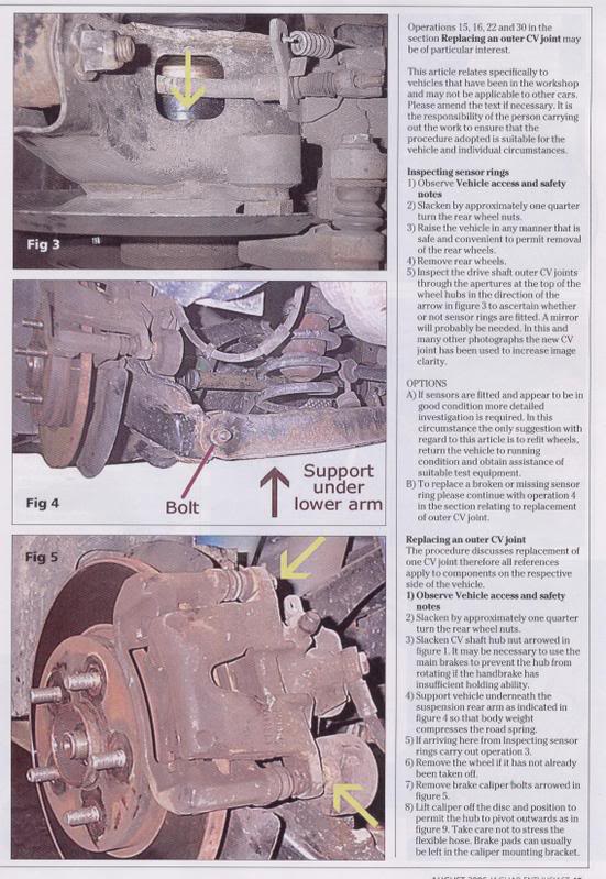

I posted a step by step thread on this a while back but cant find it.
If your ABS light is illuminating because you probably have a corroded/damaged ABS speed sensor on one of your wheels.Because the engine control unit is therefore not getting a speed reading from this sensor it will illuminate the engine management light on your dash as well.
This happened to me and the problem is now fixed:-
I pulled out off a T-junction and as I pulled out speeding car caught my eye. I had to accelerate foot to the floor. While accelerating hard my ABS light illuminated on the dashboard. 2 miles later I stopped off, and half an hour later when I started the car the engine management light also came on, so I had 2 lights on the dash all the time. I ended up getting a new outer CV joint (£60) fitted as this has a new ABS speed sensor inside it. This cured my problem.
You can pinpoint which ABS sensor has failed by getting your dealer/independant specialist to plug in their diagnostic machine and retreive the error code.On mine it had the error code C1175 which turns out to be the LHR speed sensor input on the outer CV joint.

What would we do without you buck?
Breathtaking pictures...priceless technical information....I [sm=drlove.gif] you man!
