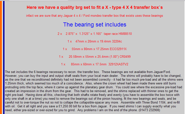

Default Part Number list
Originally Posted by Gophat
They are completely blank. I did pull them and the underside is blank as well. I found a gentleman out in the UK who sells the complete 6 bearing set.
https://transmission-rebuild-kits.co...x-rebuild-kit/
I emailed him and let him know that I have all the bearings already except for two. Hopefully he will sell just the two bearings, if not I offered to pay him for the bearing information and I will source them elsewhere.
I did some research on this a while back and may have the info your looking for Gophat. PM me.
Artax

Talking A little bit more for those so inclined
Hi all, just to elaborate a bit more to what Gophat posted re part #'s (great job btw!! . Attached is a breakdown along with bearing dims, avg prices, etc.
On Gophat's post above, there are instances where 2 parts #'s appear. These are for the bearing and the race/cup (ie: race/cup 88510 is usually included when buying 88542 & 88547 and so on).
As a tidbit included is also details on the elusive inner seal. Shout out and thanks to members astromorg, sidct, Dr_Jag, rifle, Jesse Lackman and others that contributed to the post where the seal info can be found. I think avern1 was even in there
https://www.jaguarforums.com/forum/x...er-case-93353/
