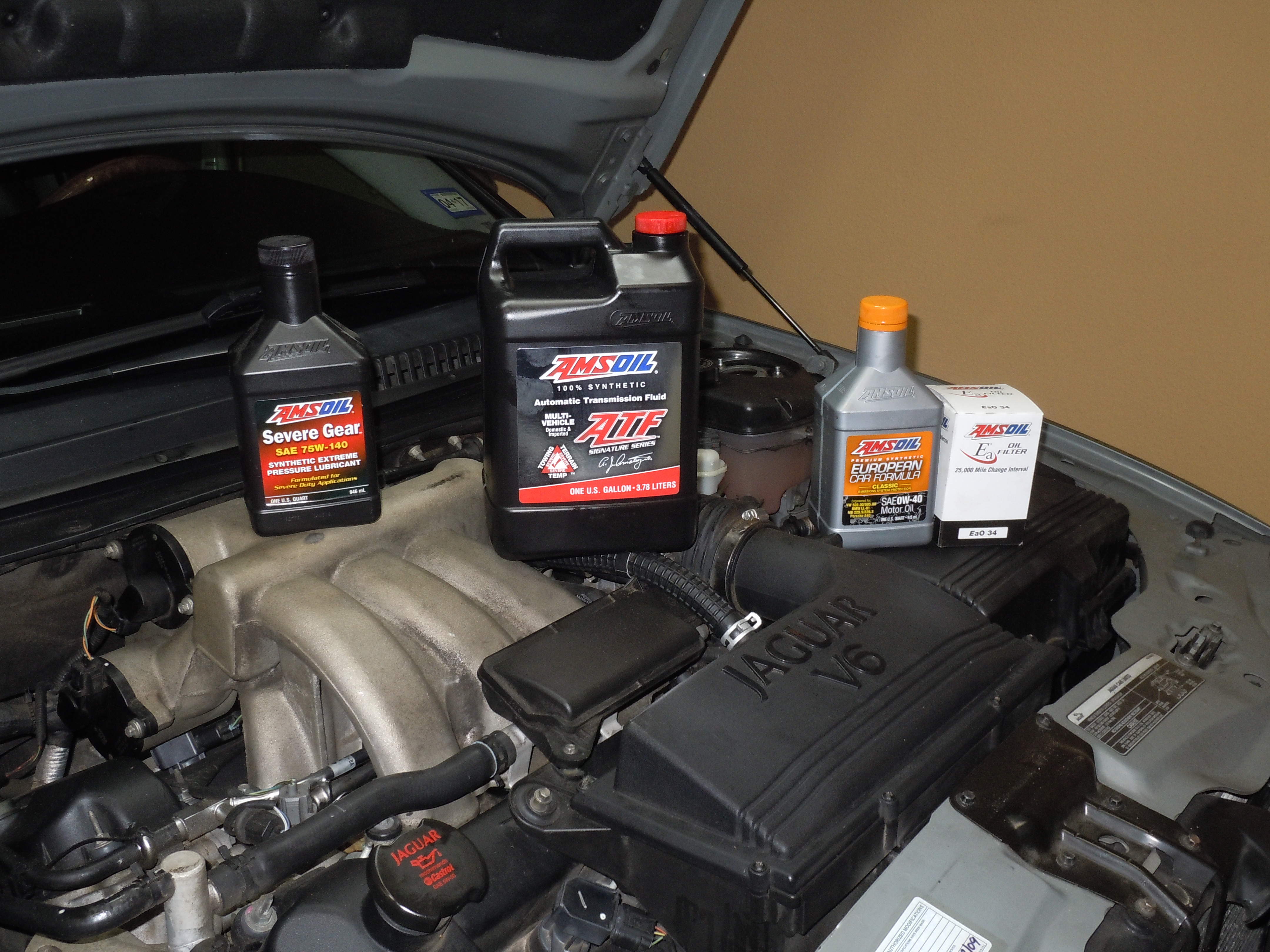

I'm thinking most if not all the TC fluid is gone, and the whine you're hearing is the resulting complaint. There's not a lot of fluid there (about half a quart), so I'd address it soon. Jaguar specs 75W-140 synthetic; pictured is my product of choice for this and also the rear differential.

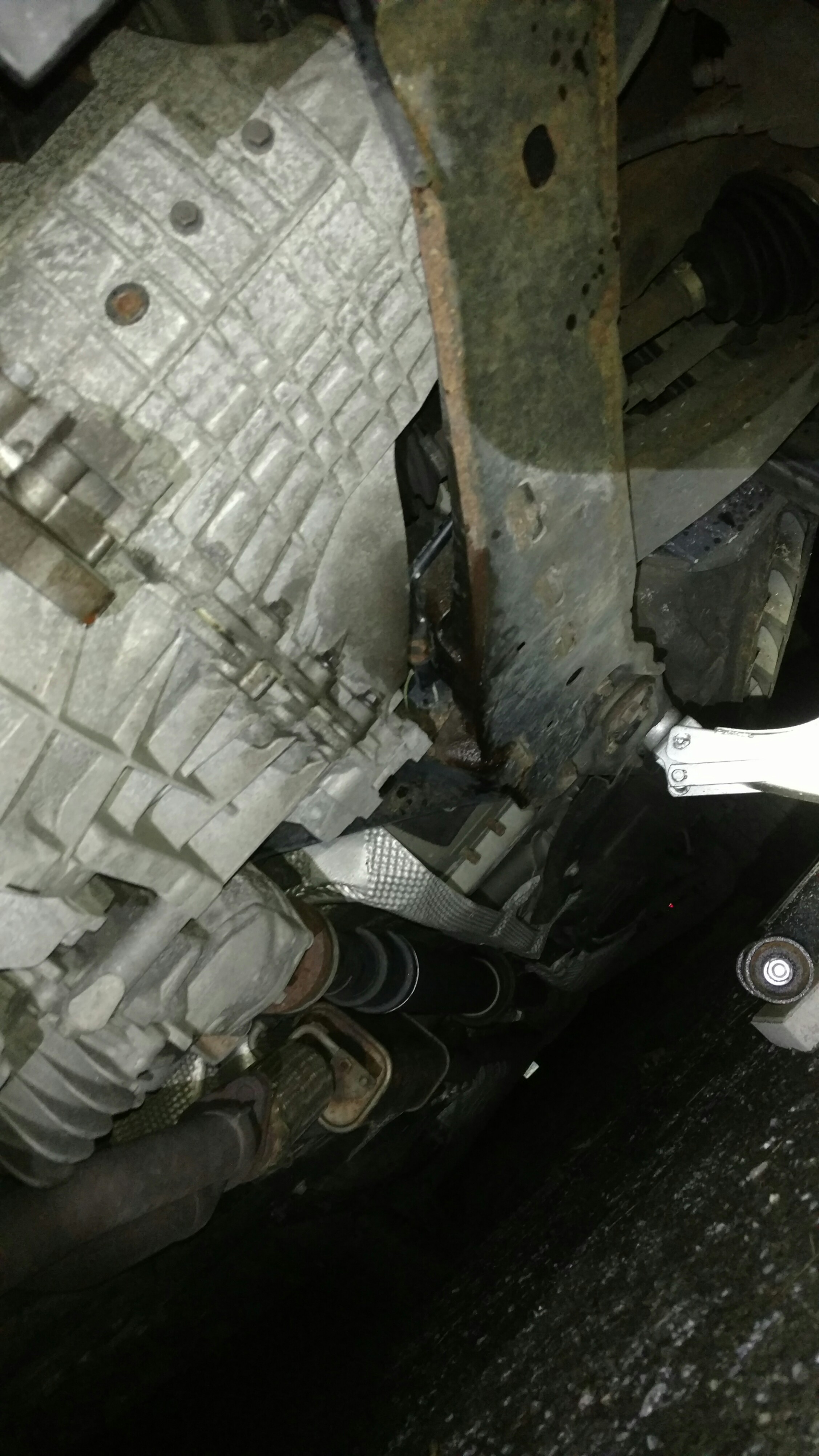

So I've just jacked the car up and crawled around under it, and I'm actually more confused, as I couldn't find a source of the leak, but perhaps I wasn't looking in the correct place. Liquid is pink which I think is gear oil? Any, any and all help is appreciated.

Pink would lead me to believe transmission fluid. The transfer case would be honey colored when new and then dark when old. Another source of pink fluid is the power steering. Check the power steering level and see if it is low.

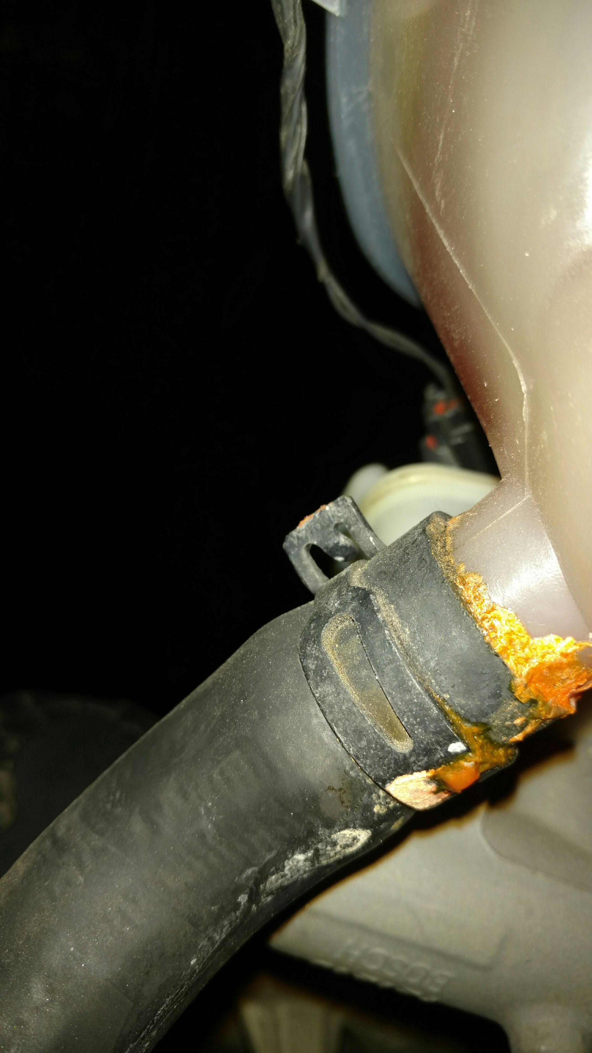

EDIT:
I do believe I found it, but I can't tell if it's the hose, the clamp, or the tank.

Picture #3 in your previous post was tip-off for me. Clarity of that drop is too clear to be ATF. Compare to a drop of coolant from your expansion tank and you'll see the match methinks. Oddly enough I'm wrasslin' with a radiator leak in my '04. Looks like a new radiator install for me.

Clean the crusty coolant and wipe off all the wet spots that you see, then watch the coolant level and every sources of pink liquid, need a bright flashlight.
