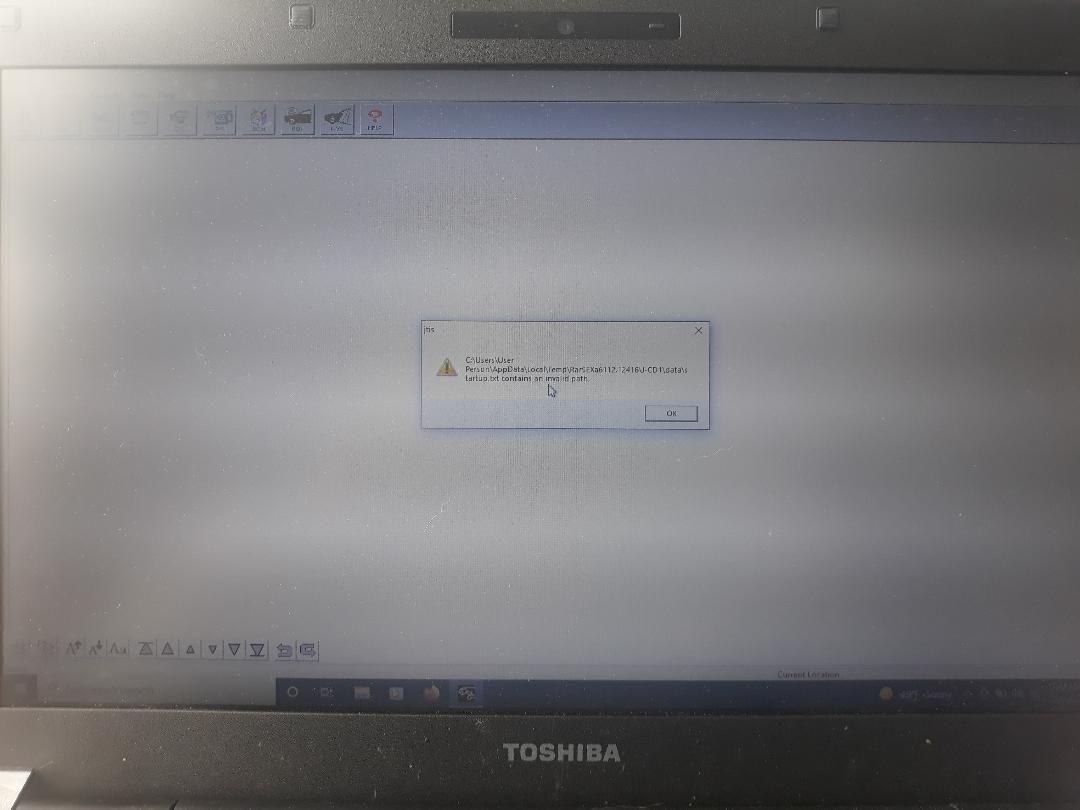

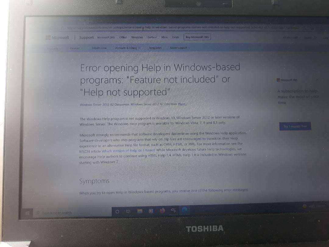

I am having a heckuva time downloading the JTIS. Seems that has been the experience of many. Program is installed but useless. Seems no "help" and nothing will open.
Perhaps because I am running of a later version (10)windows

GJS, look further into the stickies. Yes, JTIS is not fond of WIN10. But, members have figured out a way around that and they have posted how to make it work under WIN10. You will need to follow those instructions to get JTIS to work.

It appears that I have successfully installed the program but, When I open and the home page shows up, I get an incorrect path dialog box.

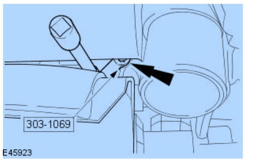

I am in the Raleigh area and I can help you get the car on the lift and/or figure out a way to get that mysterious bolt removed. It looks like maybe it is the catalytic converter support bracket which shows a special tool in the manual.
