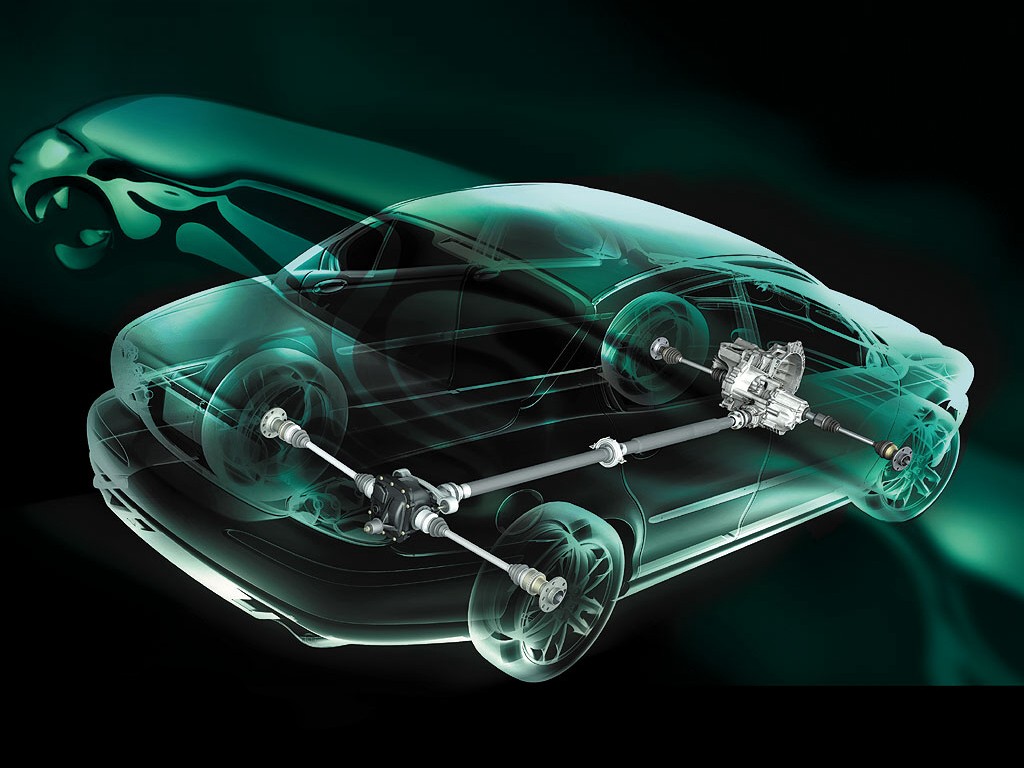

Here's a photo of a transfer case on eBay, in the photo the propshaft output is the bit closest to the camera.
Look at the picture below, the transfer case is there at the front, practically below the engine. The rear differential is the black box at the rear. The bearing that is usually greased is the propshaft carrier bearing, there in the middle of the propshaft, it's one fairly common source of cold weather whine. I had mine greased recently, and I'll know whether it made any difference when winter comes properly.
