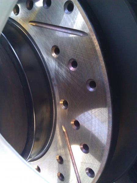

Haha! Quick question though while we're on the subject. After doing the bed-in once, I noticed my rotors are pinkish and bluish and even yellowish in the drills/slots. I'm assuming that's because they've been heated so much?
The bluish colors are more toward the outside of the rotor, then the pinkish/purplish is next, and then yellowish at the center-most part.
Does this seem normal?

The bluing that you see is the actual metal heating and cooling, that's normal as I see it all the time on the track. If you got the rotors hot enough to blue it you may have been a little aggressive with the bed in but nothing to worry about.
The color in the center of the rotor sounds like you might have glazed the pads a little bit, also an indication of a little bit too much heat. Nothing to worry about, they should clean off in time. However without seeing for myself it's kind of hard to diagnose.
The color in the center (closer to the hat) doesn't make much sense at all. I've never actually seen those pads in action so I'd take this diagnosis with a grain of salt and continue to watch the behavior of your pads and rotors.
Keep us updated on how the pads and rotors behave as I also need to do all four corners and since I can't afford the setup that I want I will need to go with a more budget route. Thanks!

I've attached a picture of the rotor so you can see the different colors. It seems like it's just from them heating up in those spots, but the color hasn't changed since I did the bed-in around 3 days ago.
