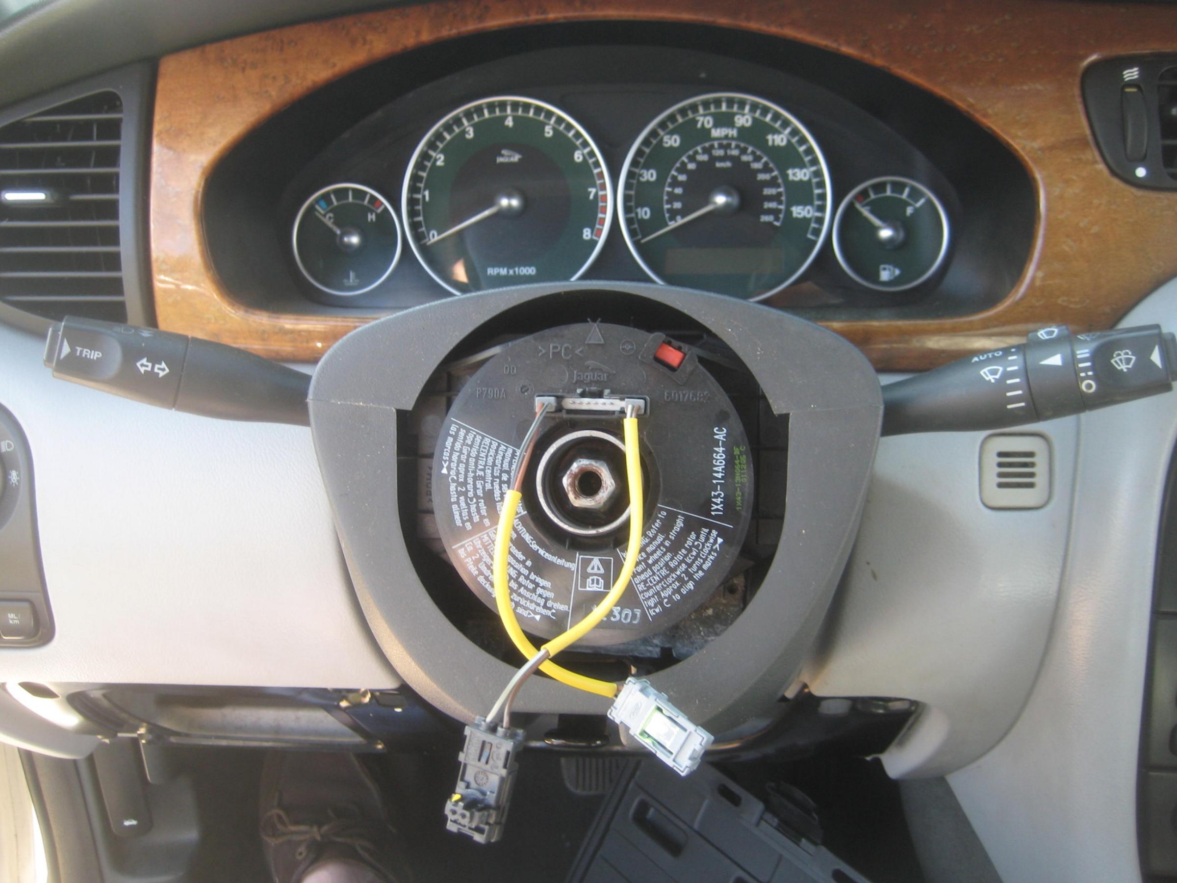

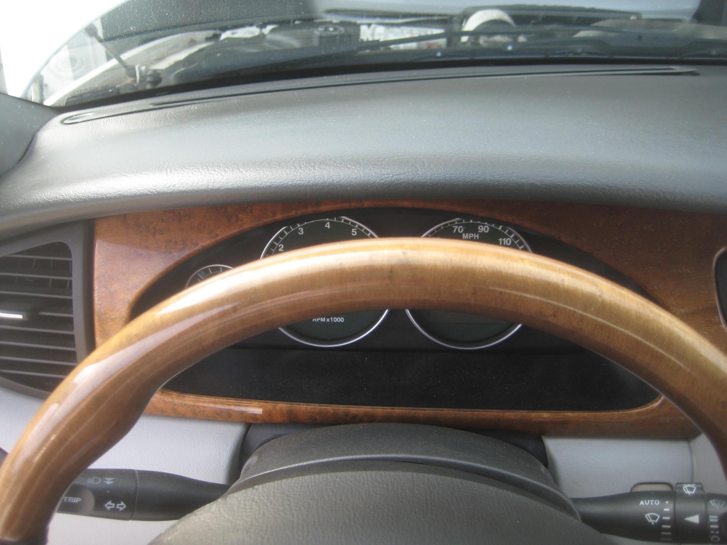

Replaced the scratched, torn, and scraped up unsightly steering wheel on the X Type today.
What a difference and it was very simple to do.
All you do is remove the two airbag screws, unplug the two airbag connectors, unplug main cruise/radio wiring harness from steering wheel, unbolt wheel and it pops right off without a puller or any special tools needed.
It only took about 15 minutes start to finish and wow, what a difference.

That looks insanely nice! I need to get on this mod my steering wheel is in need of replacement...I just have to find one that is in good shape now...been ebay hunting for a while now.

Very nice, wood is the way to go!

I'm not exactly sure about upgrading to the newer style wheel, I can post a picture of what the connectors look like on my old one so you can compare it to the newer style wheel if you'd like. From what I remember it's got a six pin plug for the crusie/radio controls in the middle at the top, and two airbag connectors on either side.
Personally I'd be a little hesitant as the physical airbag might be slightly different in the newer model compared to what you have now.

Quick question for you, how far in is that T30 screw for the airbag? I am debating on going to harbor freight and getting a set of hand torx drivers as I have a T30 bit but not sure if it it will be long enough
Just ordered me a steering wheel yesterday and looking forward to installing it just wanted a little input to see if I needed to get new tools
Old Mar 2, 2014 | 09:57 AM
ltmax's Avatar
Posts: 308
Likes: 153
From: Jacksonville FL
The airbag screws are only about 1/2" in, I used a 3/8" ratchet and torx bit and it fit no problem. If you use a screwdriver type torx you'll have to reposition the wheel so it will have room to fit but that shouldn't be too much trouble.
