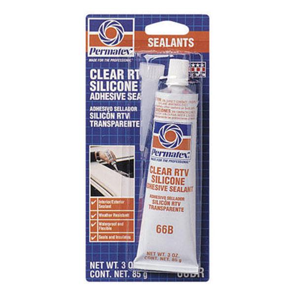

Classic issue with the X-Type
cured my rattly vent problem with....
Attached Thumbnails Very noisy front defrost vents?!?-028911-20121005003143-permatex-clear-rtv-silicone-adhesive-sealant.jpg
