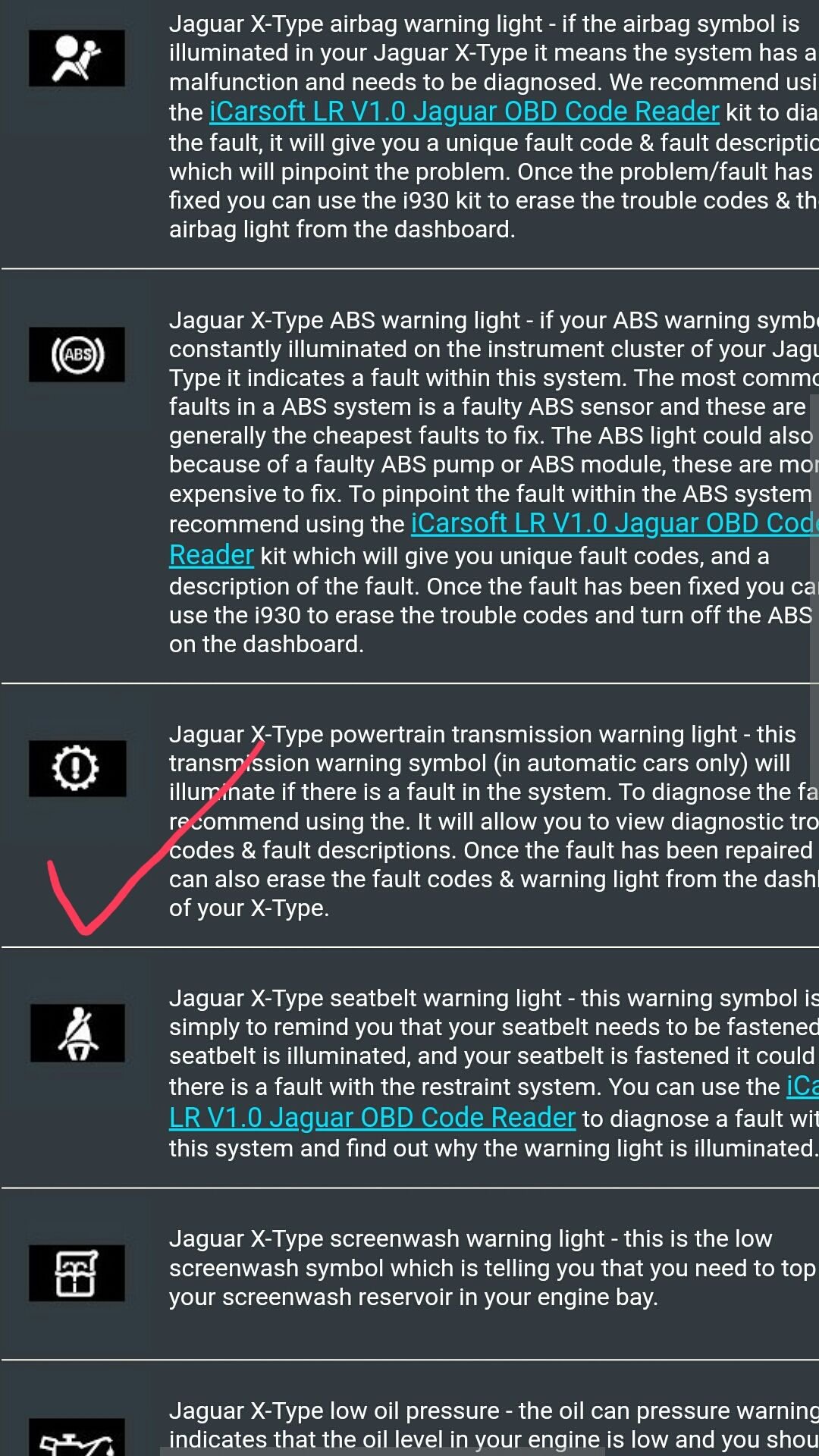

No Thermo, it's not oval, but the symbol look like the setting symbol on the smart phone with "!" in the middle, I try to attach the picture in the end of this reply.

Dell Gailey's Avatar
Joined: Mar 2017
Posts: 4,780
Likes: 798
From: Utah
Old Jan 11, 2021 | 12:29 PM
Thanguar's Avatar
Joined: Jun 2018
Posts: 51
From: Lancaster,PA
Thanks Dell Gailey, can you either copy the whole page or show me where is the threat to read it. because I only can read half of the page. Thanks again.
Old Jan 11, 2021 | 01:17 PM
Joined: Mar 2017
Posts: 4,780
Likes: 798
From: Utah
Jaguar X Type Car Warning Lights
Do a search in this forum for causes and repairs
