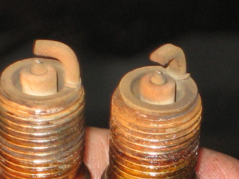

Had to make a sales call and needed to fill up at a out-of-area gas station. Within a few miles, she was skipping a beat now and again. In an act of desperation, I put in a bottle of octane booster. Seems like a light improvement. Or it could be wishful thinking.
Just finished swapping COP/plugs #2 / #4. Pic is of COP#2 and plugs are 2/4 L-R. Plugs look the same so both are either good or both are bad.
Did not notice any cracks/arcing. But this is not my strong suit.
Did notice after I changed oil the next day there was a small puddle of oil next to #2. I did miss the hole and dribbled some, but not the size of the puddle I saw.
Granny is out running around in car now so we will see when she get back.

Buckman, the plugs are the correct color, I just question the gap on the plugs. The one on the right appears to be much larger than the one on the left. It may be just the angle at which everything is at. Too large of a gap can lead to what you are seeing.

Well, it looks like that was the problem. CEL light flashed but did not stay on. Since I was on road, had AutoZone pull codes. There was a ghost code for #4 this time. Bought COP. Rplaced that and the 3 front plugs and air filter. GOSH, what a difference. Now I remember why we feel in love with the car. She's a screaming demon again. To everyone that replied, THANK-YOU!!!!
