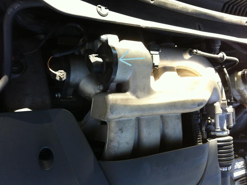

Hey all, I have an air leak coming from the gasket between the black plastic and intake. (arrow in picture) I can hear air rushing and, putting my finger on it, I can feel the air. What do I need to buy to fix this? Just a gasket? Which part? and If i'm fixing that, are there any other problems common with this one that I should have a look at too?

Cali, that is your IMT valve (Intake Manifold Tuning valve). In short, what it does is it alters the length of the intake to help improve the performance of the motor as it gets up in RPMs (shortens the length of the intake, matching the tube length with the air requirements).

billjork, there is only 1 o-ring one each valve. But, there are 2 different o-rings. There were the old black ones that were prone to failure due to the heat of the engine and now you have green o-rings that seem to last longer. There are also 2 valves. So, that might be where you are getting the 2 o-rings from too.

billbjork, the IMT valves have a single o-ring each. But, if you are talking the silver pieces (ie, the actual intake itself), then yes, there are 2 sets of o-rings for that. You have what are called the intake gaskets and then the manifold gaskets. The intake gaskets are mounted between the two halves of the intake and those are the ones that most people are familiar with. Then you have the manifold gaskets. Those are mounted between the intake manifold and the heads themselves.

Okay, so I went to the dealer and the guy was actually really nice. According to him, the factory seals are notorious for leaking after so much time. He sold me two seals, one for each valve, part number C2S40669005 for $5.06 each and it fixed the problem.
He also strongly recommended new inlet-manifold gaskets XR843536006 (probably since they were $13.23 each and I needed 6 of them) but since I was doing spark plugs I figured why not. Car runs notably better.
