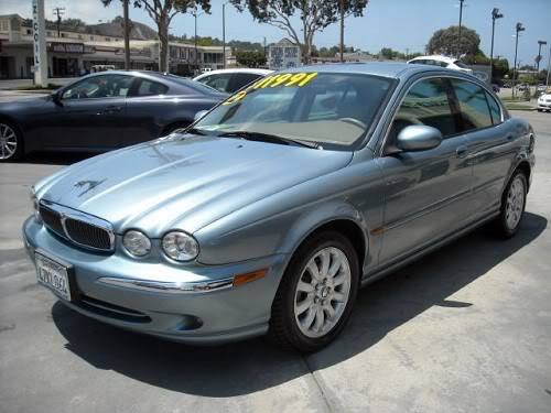

Can anyone tell me what the specs are on this wheel?
Looking for Width and Offset. I believe its a 16" I would have to look again at it, but im more concerned with width and primarily offset.

Yes, but as I thought, I have the 16" wheels. Do you happen to know the width and offset of the 16" wheels pictured above?

The wheels in the car pictured above are 16" x 6.5" wide. Offset is 52.5 mm. I just read this off of a spare wheel in my attic.
Mark

Very cool, thanks mark!
