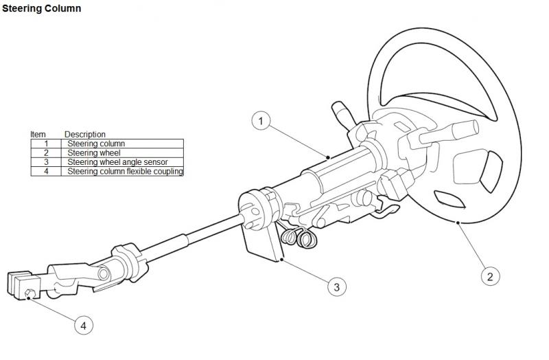

I'd go back to the dealer who did the work and tell them to put it right.
It's a very basic mistake not centralising the steering wheel when reconnecting the steering. Absolutely infuriating for you looking at at off centre wheel when driving straight ahead but not dangerous.
Two ways to do this. Either remove the steering wheel and centralise it or disconnect the steering at the flexible coupling (item 4) and centralise the wheel before reconnecting.

chardy, they do not need to drop the steering rack. They should be able to make all the adjustments from the tie rod ends to get the steering wheel back to straight. If they are looking at pulling the steering wheel, then they are going about things the hard way.

2006 model has DSC. I wouldn´t adjust alignment from steering wheel.. Flexible coupling won´t work either. Steering rack axle isn´t round so there´s no way to adjust it from the coupling (been there, tried that..)
I´d go with Thermo on this.
