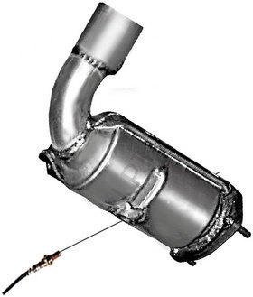

It appears one or both of the cats are bad. P0420.
Has anyone found a reasonable solution to this?
Parts and labor will almost cost more then the car is worth.
I'm in Colorado so we do have to do emmissions testing here.
Thanks in advance.

Google o2 simulators, also if you move the sensors out of the exhaust stream with oil foulers for spark plugs(dorman sells) this many times is enough to make them "think" the cats are still working properly. Dont be tempted to use aftermarket cheaper cats. Youll waste your money. I have taken many off and had to argue with customers about the problem.
"its gotta be something else, i just replaced those last yr!"
no theyre cheap crap and that why when i sell used cats i get about $50-75 per car for a oem, and $5 for aftermarkets. They just dont have enough of the precious metals that the cats use to clean the exhaust. Which sucks because labor on the rear cat is expensive. Front is pretty easy

When you say aftermarket, does that include this one?
BENCHMARK CATALYTIC CONVERTER ASSEMBLY
Benchmark catalytic converters are considered to be the industry's standard replacement catalytic converter. It is the recognized leader in fitment and durability. It features perfect fit and repeatability and its performance results are continually monitored by Benchmark's internal emissions laboratory to insure quality loadings which eliminate OBDII issues caused by many universal catalysts.
Specifications
  • With oxygen sensor port
  • Standard assembly with one catalytic converter
Notes
  • 49-state legal; Not for sale or use in California; Cannot be shipped to California addresses
  • Location: Front
  • Color/Finish: Natural
  • Emissions: 49-state legal - no CA shipments
  • Product Fit: OE replacement
  • Quantity Sold: Sold individually
  • Tube Material: Steel
  • Case Material: Steel
  • Anticipated Ship Out Time: 1-3 business days
  • Catalytic Converter Quantity: One
  • Warranty: 2-year or 25, 000-mile Benchmark limited warranty
Fits the following 2003 Jaguar X-Type</STRONG> submodels:
  • 2003: Base; 6 Cyl 2.5L;
