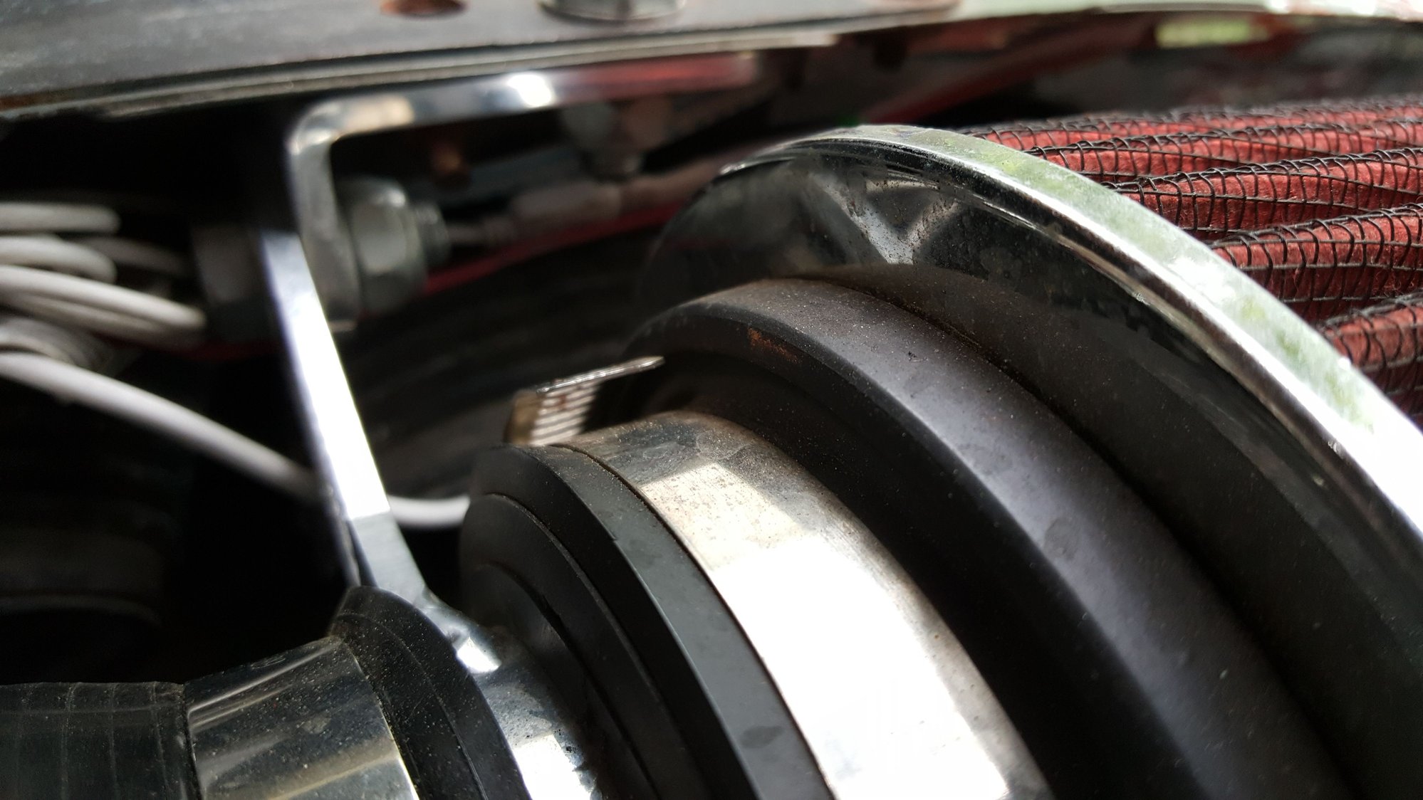

Hi, i just finished installing a cold air intake in my x-type (love the sound) i have just a little problem, i have no idea how to mount it into place, is there any type of kit or something?
thanks in advance

Just a real quick update for anybody who was in the same problem as me, you need to buy a Intake bracket kit from spectre and conect it to the screw on the clasp and then just look for any bolt in the engine bay to hold it down.

I couldn't ever get that style bracket to work, no matter what I did or where I mounted it, it always rattled loose and the filter would end up resting on the ignition coil. I eventually switched to the bracket I linked and I haven't had a problem since. I bolted the little 90 degree piece to the bottom side of the lip on the core support through the mounting plate that holds the catch for the hood and pointed the the actual bracket towards the backside of the radiator where it could mate up to the 90 degree piece. Nice and stiff now. I can post a picture later if you need me to.

2nd picture is looking towards the front of the car from the intake manifold to show where the 90 piece is mounted. At the bottom of 1st picture you can see the bolt that secures that 90 through the latch bracket and core support. I need to adjust mine actually...
You could, of course, figure out your own way of using the bracket pieces and mount it somewhere else.
