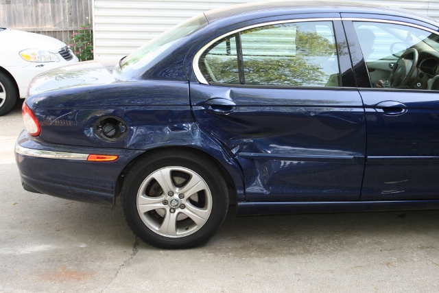

also the jag has been in the body shop for a couple weeks thanks to a work truck backing into me, about 5 grand in damages. i will try to post a pic.
