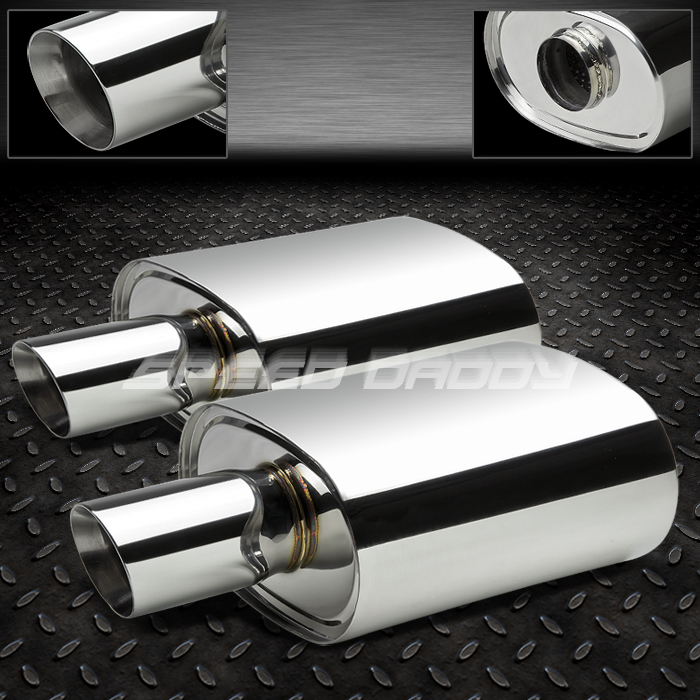

I am so on a budget right now. Let's just say it's another 3 day weekened and there's no holiday. Do you think 2 of these bad boys would fit under the x-type? Or any other style ebay muffler for that matter with a tip. I've scoured low and high but having trouble because of the long tip length needed and limited space under the bumper. These would be about half the cost of the magnaflow type mufflers. I know they kind of look "rice burner" but they also have them in plain chrome.
Slanted Muffler Tip Diameter: 3.500" with Removable Silencer
Muffler Tip Length: 5.375"
Inlet Diameter/ Length: 2.375"/ 2.500"
Canister Length X Weight X Height: 11.750" (L) X 4.375" (W) X 4.375" (H)
Super Lightweight 19.750" Overall Length
Performance Oval Style Racing Sepc.
Made of High Quality Stainless Steel Material
Improves Exhaust Velocity Performance. Offers Great Air Flow and Higher Horsepower Gain
Instantly Increases 5 - 10 HPS for Most Vehicles
Aggressive Deep Discharge Sound
100% Brand New
Professional Installation is Highly Recommended (No Instruction Included)
These ones are also bad *** (can we say that on here?) but they are a little bigger and about twice the price. They have long tips though and are freaking sweet looking. Not sure if you could cram them under the bumper. What do you think? I was just trying to find a cool style that would fit on the x-type. These are probably a little out of my price range but I like the look of them.
Slanted Muffler Tip Diameter: 3.50"
Muffler Tip Length: 6.25"
Inlet Diameter: 3.00"
Inlet Length: 0.75"
Canister Length X Weight X Height: 11.625" (L) X 10.250" (W) X 6.250" (H)
Super Lightweight 17.75" Overall Length
100% Brand New
Attached Thumbnails X Type Muffler Delete-mfl-45-35-25-s-bt.jpg   X Type Muffler Delete-mfl-oval-3-35-rl-x2.jpg
Old Jan 30, 2014 | 10:12 PM
Justink201's Avatar
Posts: 604
Likes: 92
From: tampa bay FL
How much will a set of either of those cost you?
