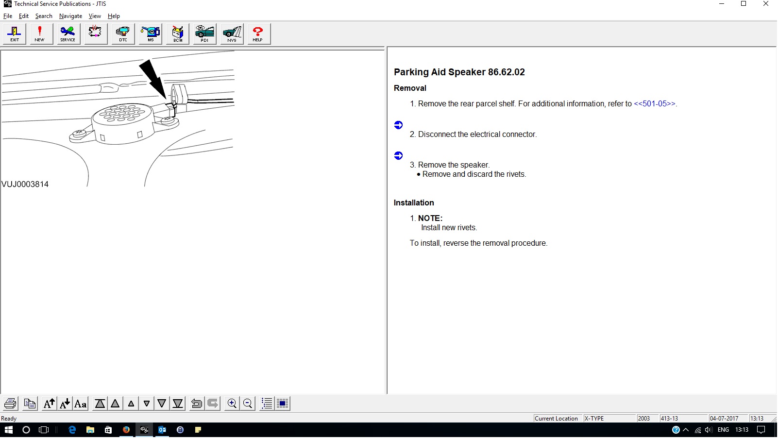

location of the speaker for the rear parking sensors anyone please?

Colin, if you have the standard sedan, it is bolted to the underside of the rear shelf. It can be accessed by getting inside the trunk. You will see a black box with holes in it.
If you have the estate, it is tucked back into the corner of the car. Do not recall exactly where though.

Welcome to the forum colin H,
I've deleted your identical post from X308 forum.
The Parking Aid Speaker is under the rear parcel shelf.
