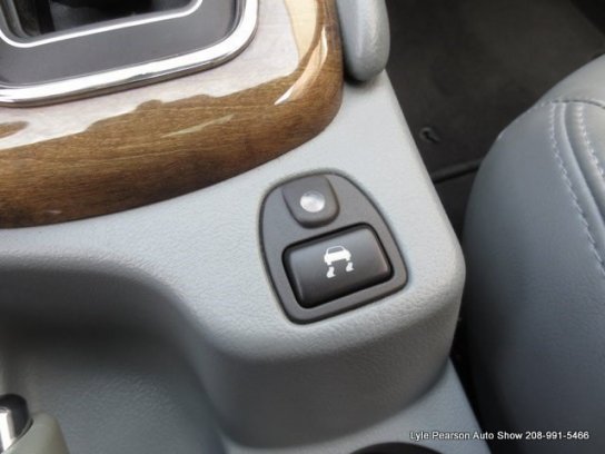

how can one tell if this is just traction control or DCS?

Mine with message center and DSC says DSC off/DSC on on msg center when the button is pressed. I assume with only traction control it would say TC off/ TC on but I'm not 100% sure.

If it has the button as in post #14 it has DSC
If there are slots for coins instead of a button no DSC
