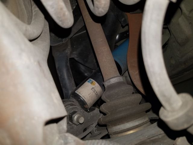

Here's a photo from under my Wagon. Something is unique if the label means anything. This is original untouched 36K miles.
Estate label on rear shock
Hope this helps
Last edited by DaveAllen; May 18, 2023 at 02:23 PM. Reason: Added word "rear" to help identify location of photo.

Looking on a UK Jag spares site, it lists the Estates as having a different shock absorber number (C2S46575) compared to the standard and sport shocks used in sedan with 2.5 and 3.0 engines.
Also different again from the shocks used in 2.1 variant.
https://www.jagspares.co.uk/category...pension?page=1
Page 3 has the Estate shock listed but no picture.
Not having owned an Estate model myself, I can't tell you if the difference is the top eyelet, damping rate, or the physical length of the unit, but seems to be a separate part for the Estates.
