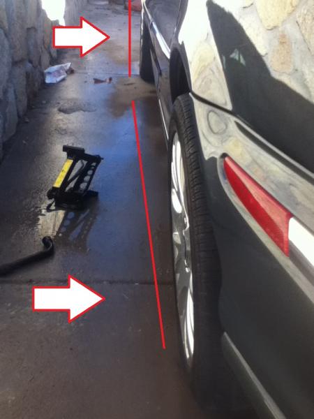

I had this problem with my x type, I think the back wheels are a slightly inclined to the left side, has anyone had this problem before?
I put some pictures so that I hope to see some opinions can help !!!
Attached Thumbnails X-type wear trouble-img_0941.jpg   X-type wear trouble-img_0946.jpg   X-type wear trouble-tires-wear.jpg

kalacho, what I would tell you to do is to take the car out for a drive and find an exit/on ramp that is a big sweeping 270 degree turn. Now, as you are in the turn, give the car little bumps of the gas pedal (like you were going to pass someone on the turn but then realized someone was coming the other way). Does the rear end of the car feel like it is going to step out to the side? If so, then your lower control arms are shot and they need to be replaced (easy replacement, 2 bolts, old arm comes out).
After that, the wear on the tire looks fairly normal for how my Jag wears the tires. As long as you are rotating the tires regularly, the outside wear is due to turning and the inside wear is caused by the rear tires leaning in at the top (typical for the X-Type). If you want to get the tires exactly where they should be, you will need to replace the lower and upper control arms. There is no need to replace the main suspension arm (has the spring cup mounted on it and is the big 3 foot long arm). You can also try pulling the wheel off and then seeing if you can spot any loose joints by attempting to twist the rear hubs side to side (like you were going to have a 4 wheel steering car). If you see movement, that is bad and the part that moves needs to be replaced.

Have a four-wheel alignment done. You may find that your rear alignment adjustments are out of range. This is due to bushing wear in the rear
control arms. This is a common problem with our cars but can be fixed by
replacing both control arms for a couple hundred dollars.

Has anybody tried a different rear camber setting (assuming it's adjustable) to correct accelerated inside wear? The inside of my right rear tire my car really gets eaten up fast.

yeah, i have that right rear tire wear. mine gets eat up fast also and i can tell there is a problem. it almost feels like it 'fishtails' when i hit a bump or uneven spot in the road. the problem is 10 times worse when it rains. i hope to hear some more posts, but i think i will start with those control arms.

jag32, odds are, you have a lower front arm that is worn and that is causing the rear tires to shift a little, leading to the fishtail feeling.

Ok yesterday I put my new brakes and all perfect,but my rear driver side are. Very worn and need replace,is possible this wheel hub affect my camber like the pics? Cuz y move the hub and it move to all directions with not problem.
Any place to buy it cheap?
And the rear front lowers arms?

kalacho, if you pick the tire up off the ground and you can get any play from the tire (rest of the suspension is stationary, then you definitely need to replace the wheel hub. yes, it can lead to the tire leaning, but normally that is fairly significant wear in the hub to get any noticeable lean.
