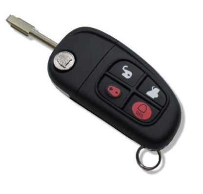

Old Aug 6, 2012 | 02:58 AM
Joedy,
1. you don't have a key fob like this?
2. The 'interlock' prevents you moving the gear selector out of P (park) until the brake is pressed. The vehicle will only start in P or N (neutral).
Did you try Thermo's check with the map light?

Graham, correct I do not have a FOB like your picture, just two keys (bought vehicle used and that is what it came with only
Even if I press on the brake it will not let me move the gear shift out of Park
