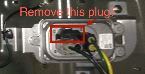

Yes, it will come back. So while you’re in the trunk:

Battery went in fine. I didn’t see that connector in the trunk, must be under more trim.

OK, sorry. I get all my Jags confused. Right side behind trunk trim panel.

Thanks! I’m guessing the 2018 XE doesn’t have a 2nd battery, but has a super/ultra capacitor for start/stop.

The module I referenced is a “voltage conditioner” or something and monitors the car’s capacity to maintain the start/stop.

Well, Start/Stop did return with the new battery. I find it interesting that it didn’t work for at least a couple of years. I’ll probably pull the plug you mentioned.
