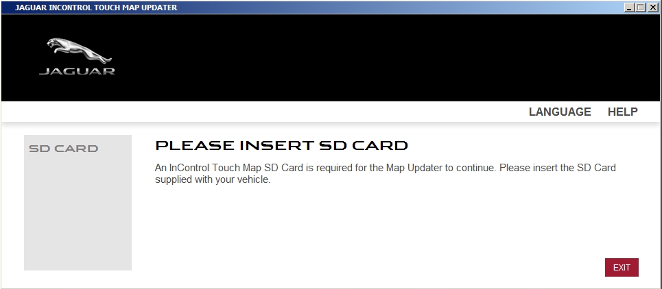

You mean this site/program JAGUAR INCONTROL TOUCH MAP UPDATER
If they have finally included Australia in that, well it's a step forward.
I can't check it as the program does not let you proceed until you plug in an "official" SD card to your laptop.
As for the paid updates vs. free of charge, yes that's a sore point. What applies in the UK or other countries doesn't always apply here.
Us owners of older Jags have always been stung with overpriced map updates, it's still $200 for a 2-year old map for my 13-year old XJ... same cost if you have a "new" car with the previous generation Infotainment, like an F-Type or XF. It's cheaper now than what it was before though, not too long ago it was something really ridiculous like $450 for a map update...
I don't know of anyone in Australia who got a free map update from Jaguar, unless the dealer paid for it out of his own pocket...
