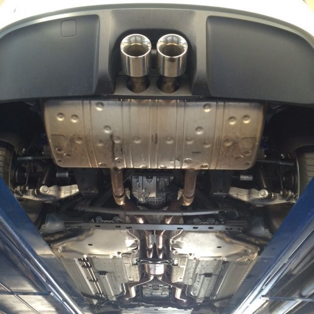

I've attached a diagram of the exhaust on the XE, showing the two center resonators in question (which appear after the joined resonator, but before the rear mufflers). It was my understanding that the V6 F-type had this joined resonator but not the two center resonators that we have on the XE... also attached photo of stock F-type underside for comparison (I'm sure you're already familiar with this view ).
As you can see the entire center section bolts in and no welding would be required if done properly... As you say its probably best to retain that first center muffler since it may contribute a lot to the tone, and also serve as a sort of X-pipe. Both the XE and F-type have this first muffler.
Similarly the combined size of the two XE rear mufflers seem comparable to that of the F-type rear muffler, although the internals are most likely quite different. But perhaps volume is not "rear-muffler-limited", if you will, and instead controls the tone.
CRS 123 had replaced his rear mufflers with smaller ones from another manufacturer and drone was unbearable... So the center section seems like the lowest hanging fruit in terms of achieving volume increase.
My experience with modifying exhausts is nil so feel free to school me on this haha.
XE:
and the bottom of my XE:
V6 F-type:

Got it. So my educated guess would be that those two resonators are there for one of two reasons or a combination of both:
1. The Twin Rear Mufflers aren't able to get the sound level down as effectively as the transverse FType rear muffler so they added resonators to compensate.
2. JLR just wanted a more muted exhaust note for the XE versus the FType, assuming (probably correctly) that a fair few of their XE buyers wanted a quieter exhaust.
If it were my car, the first thing I'd do is change out the cat section for sport cats. However, there's more than one way to skin a cat and everyone likes different stuff. We are interested in making all of it. I'd like to make a 200 Cell Sport Cat, a center section with an XPipe and one small silencer, no resonators, and look at the Rear Muffler section as well, possibly a Valved Setup for those interested.
I agree, the low hanging fruit is likely to be a center section and/or possibly sport cats with stock back boxes, and also agree on keeping things bolt on/bolt off so cars can be returned to stock if so desired. A lot easier to manage if cars are leased or if people want to sell in 2 or 3 years and not every buyer wants exhaust mods.
All we need is parts, and a willing owner. Some of the stuff is quick to develop, some a little longer.
