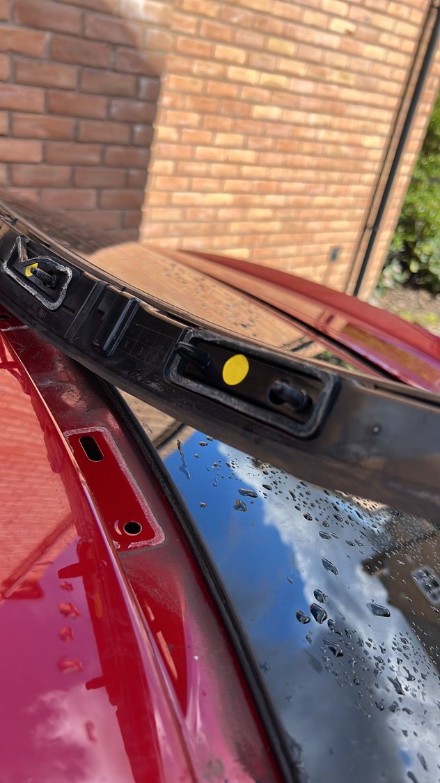

I’ve spent the morning tracing and tracking down my water ingress problems.
for some reason there was a “top hat” missing from the rear screen trim that holds the high level stop lamp.
Getting the head lining to drop for access is a nightmare of a job to get to the fixings…
trim off , taped up the aperture holes and the car stayed dry !!
Will follow up and order a new trim and top hat.
question now , does anyone have a known good tcu I can buy and try get this paper weight started again ?
I won’t rebuild the interior until the new trim piece is installed
Trim removed
Missing top hat

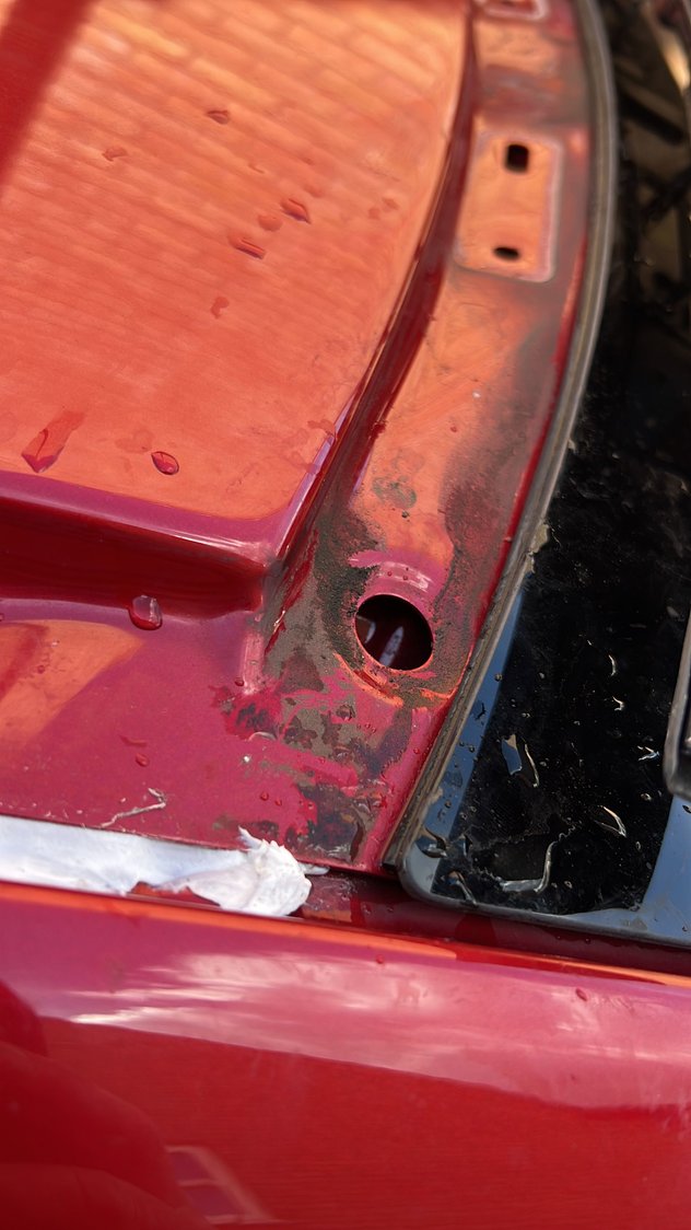

Default Good vs bad
Good side with top hat
Bad side no top hat
