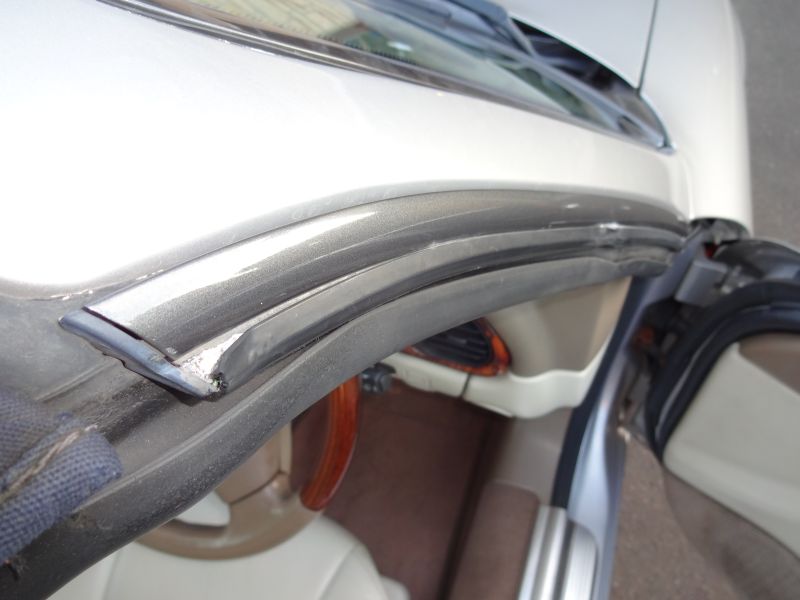

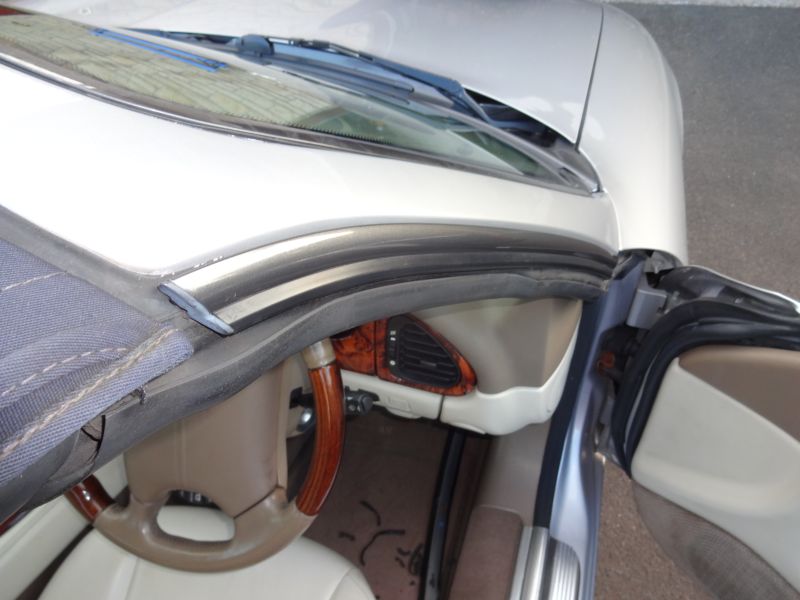

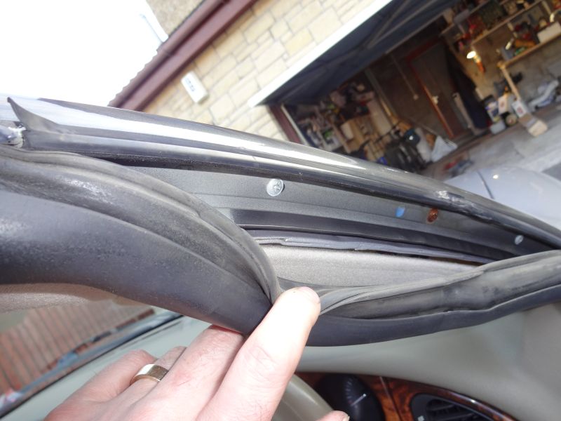

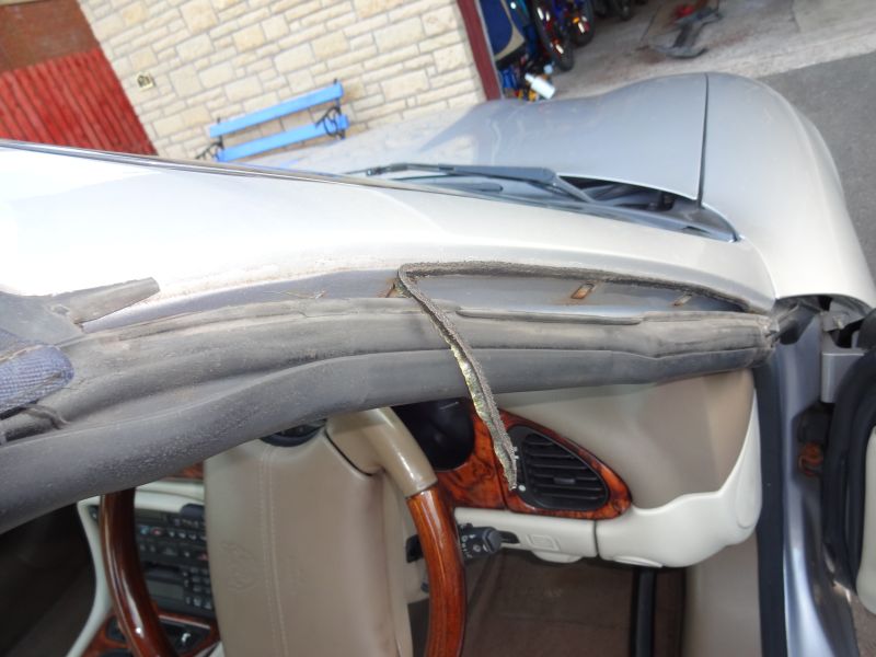

Finally got round to fitting my ebay-California trim today.
It took a bit of tugging to pull the seal free.
There was also some double sided tape holding the trim in place.
Cleaned up.
I put a strip of double sided tape on the new trim.
New one in place.
