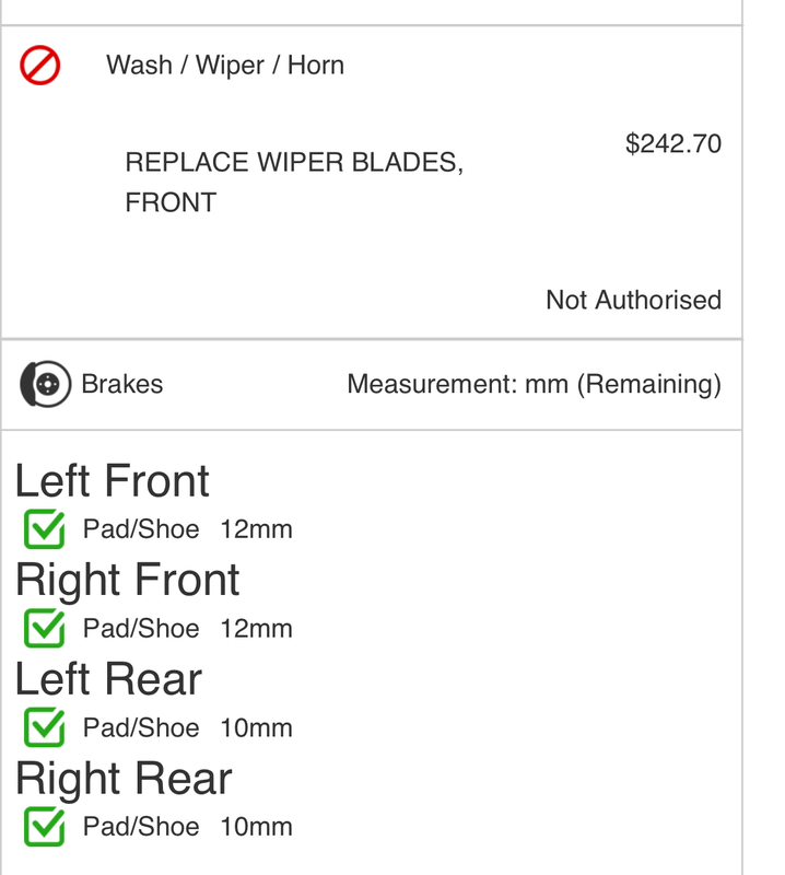

Had our XE serviced a couple of weeks ago at the dealer. In addition to needing a replacement a/c line after the system started blowing hot instead of cold, one of the service recommendations was the need for new wiper blades. I wasn't surprised, this car doesn't really get driven in the rain all that often, so these were the original wiper blades from 2015! As the car needed to go back for the replacement A/C line, the service advisor said he would send through a quote for both. Now, I'm a busy person and was all prepared to pay them to do the wipers.
However, I almost choked on my fizzy drink at the absurd price of $242.70 AUD for supply and fit two rubber windscreen wiper blades!
I'm all for setting fire to cash when it comes to cars, but that price is taking the pi.s! At $100 I would have said yes, would have saved me the time chasing down and waiting for the correct blades, then the fitment. But at $243, the dealer is relying on "non-car people" just saying yes because they don't know any better. And this is why the dealership service departments have a bad name.
