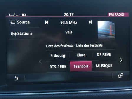

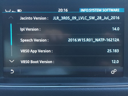

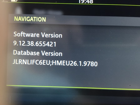

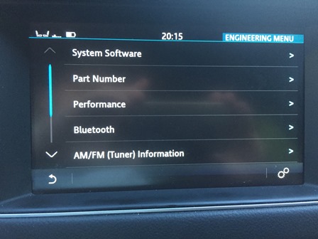

....constantly losing time on the ICT. I apparently have the latest software but quite honestly do not know any longer which reference number is which for comparison. Full version numbers of components can be read using the hidden menu accessible via FM radio (only) by pressing and holding the Source button at the top right. (Holding the Source soft key does not work.)
The version numbers are completely different from the software version number visible via Settings on the Navigation...
In attachment I have put accessing the hidden menu via FM radio and the corresponding Navigation version. These are all from July 2017.

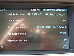

Originally Posted by jbn
....constantly losing time on the ICT. I apparently have the latest software but quite honestly do not know any longer which reference number is which for comparison.....
Mine was delivered 9/2016 and the software appears to be a lower rev than yours. No problems with any systems so far. I'm due for a service and sw upgrade next month and will post the results. What's the OP's rev level?

Here's the screen shot after my service and 'software upgrade'. Everything looks the same as my last screen shot before the service. The service advisor told me it was a PCM upgrade (Powertrain Control Module).
