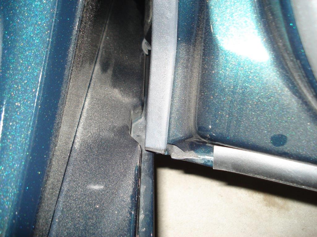

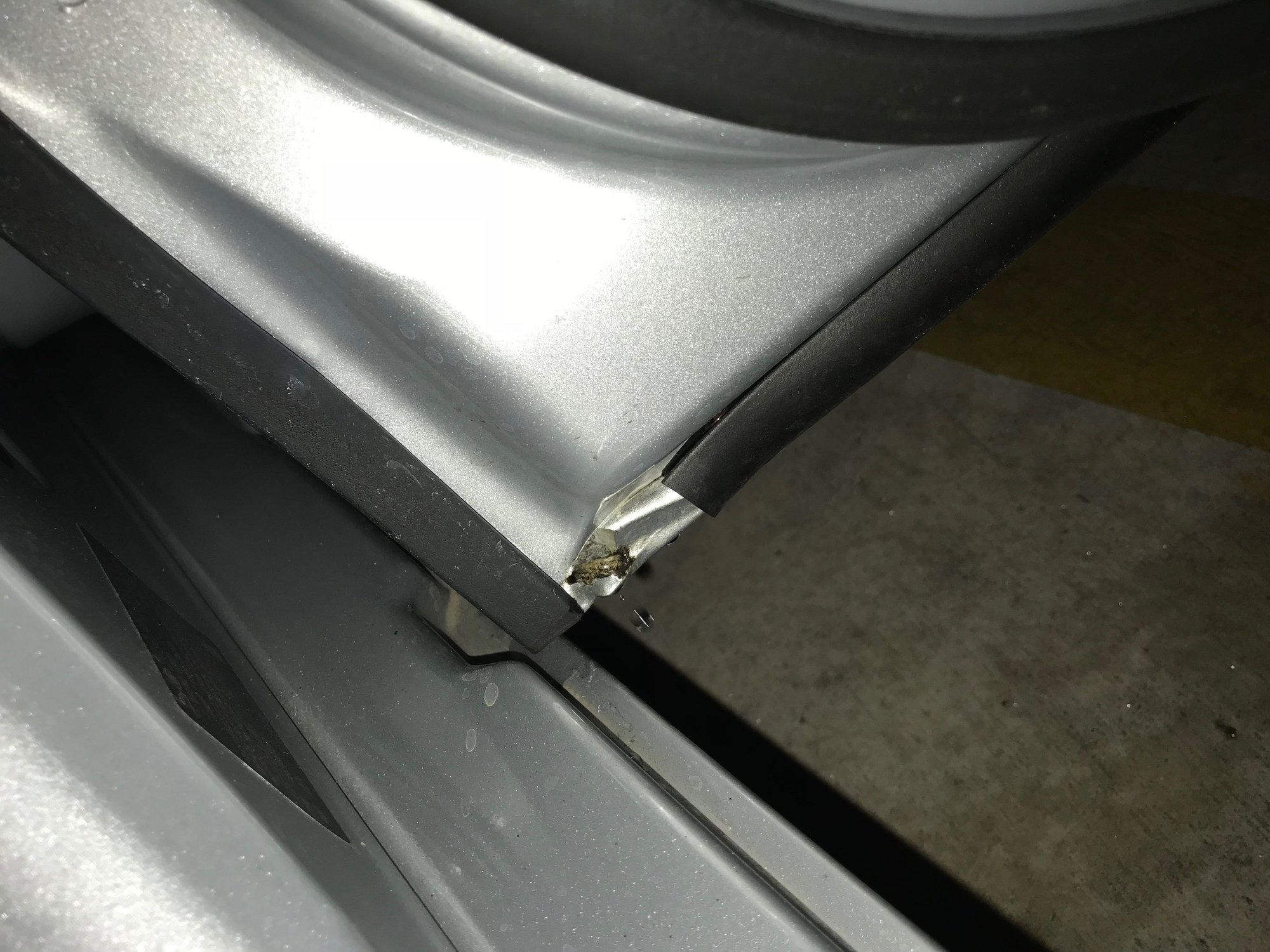

So after waiting on the dealership, I took it upon myself to trouble shoot the drainage issue, come to find out that it's not the sunroof not draining, it's my right rear passenger door. So the first time I had it unplugged it was not the sunroof. There is a makeshift drain plug, see picture, for some reason it was clogged, used my keys to unclogged the hole and no Drain plug unclogged
Drain plug clogged
more water.

Are you sure that's the only drain point? On my (and other) XFs the drain is at the lowest point of the door, underneath it, towards the rear of the door. It's covered by that rubber door seal which has a hole in it that's supposed to line up with the drain hole in the door (but doesn't, and blocks it). Is that silver piece a door trim piece I see or what is it?

Yes, on my car, these are the only drain holes and located in the same location on all four doors, I removed the black strip at the bottom of the door and no other holes. As for you issue, that sounds more like the sunroof plugs are blocked and unfortunately, I have not found or looked for those locations.

I don't have any leaks and trying to keep it that way. Look at these pics of the back passenger door seals. That pencil sticking out is where the hole in the door is that is supposed to match the hole in the seal. The other pic is at the front of the door seal end where your pic shows yours' to be. They are both '17 models so something is weird here.
Attached Thumbnails 2017 XF-S sunroof drain plug location-front-end-seal.jpg   2017 XF-S sunroof drain plug location-drain-hole.jpg
