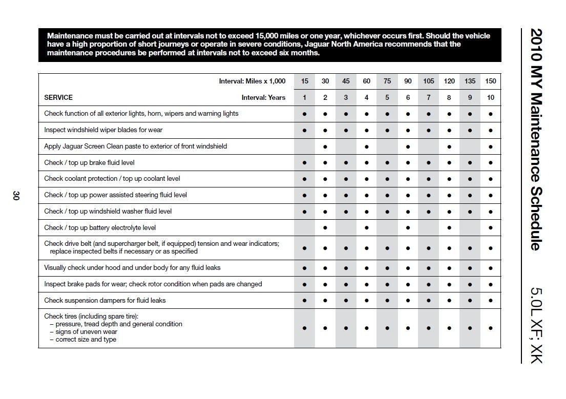

Welcome to the forums adb1980,
It should be everything on the Maintenance Schedule without the Invoice at the end.
Here is the 2010 XF 5.0 litre Maintenance Schedule as an example:
