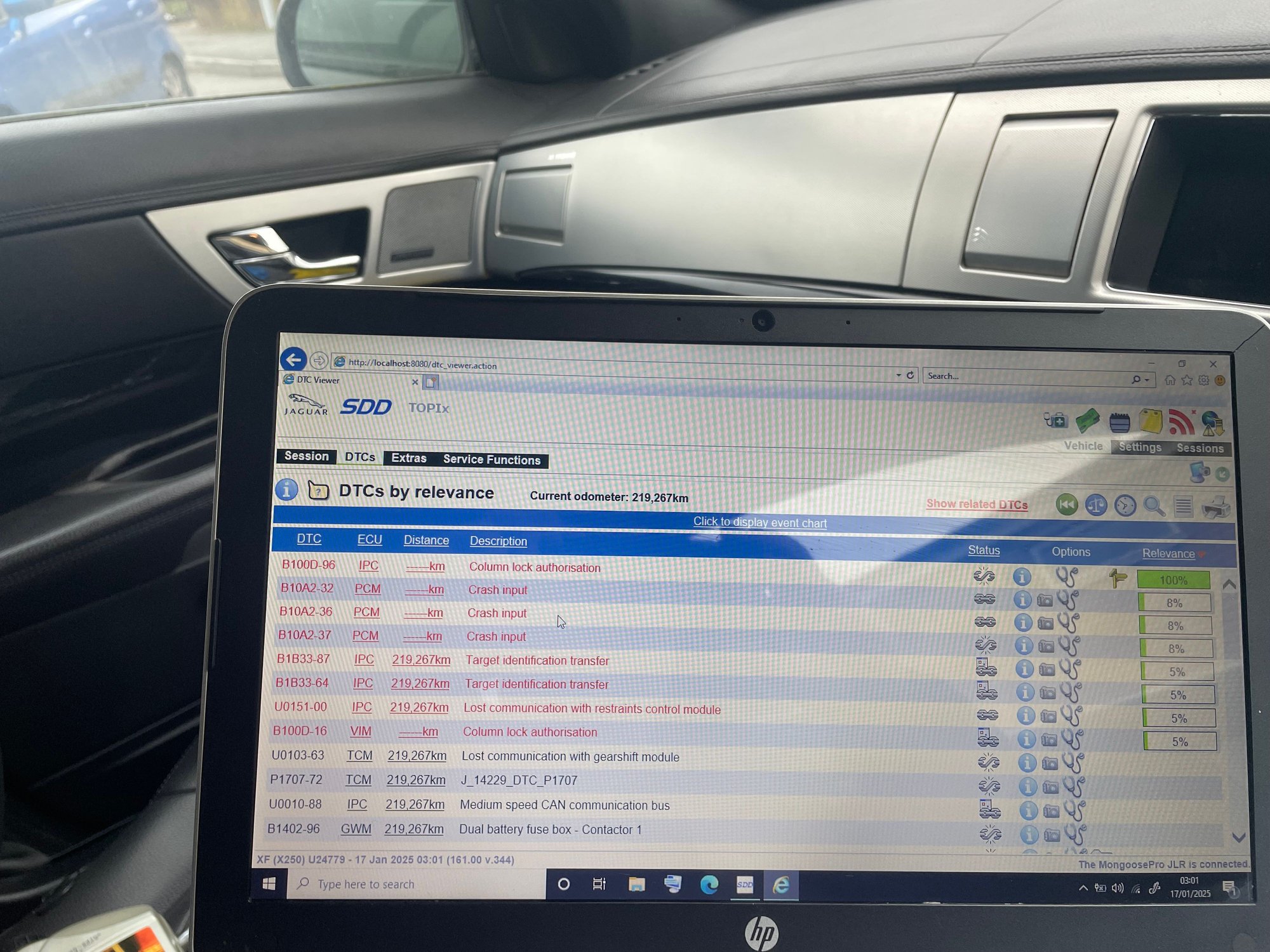

the car starts up for about 3/4mins then cuts off soon as the airbag light comes on then don’t start back cause it says check pedestrian system but it’s only done this since the batteries went dead any help would be great thanks

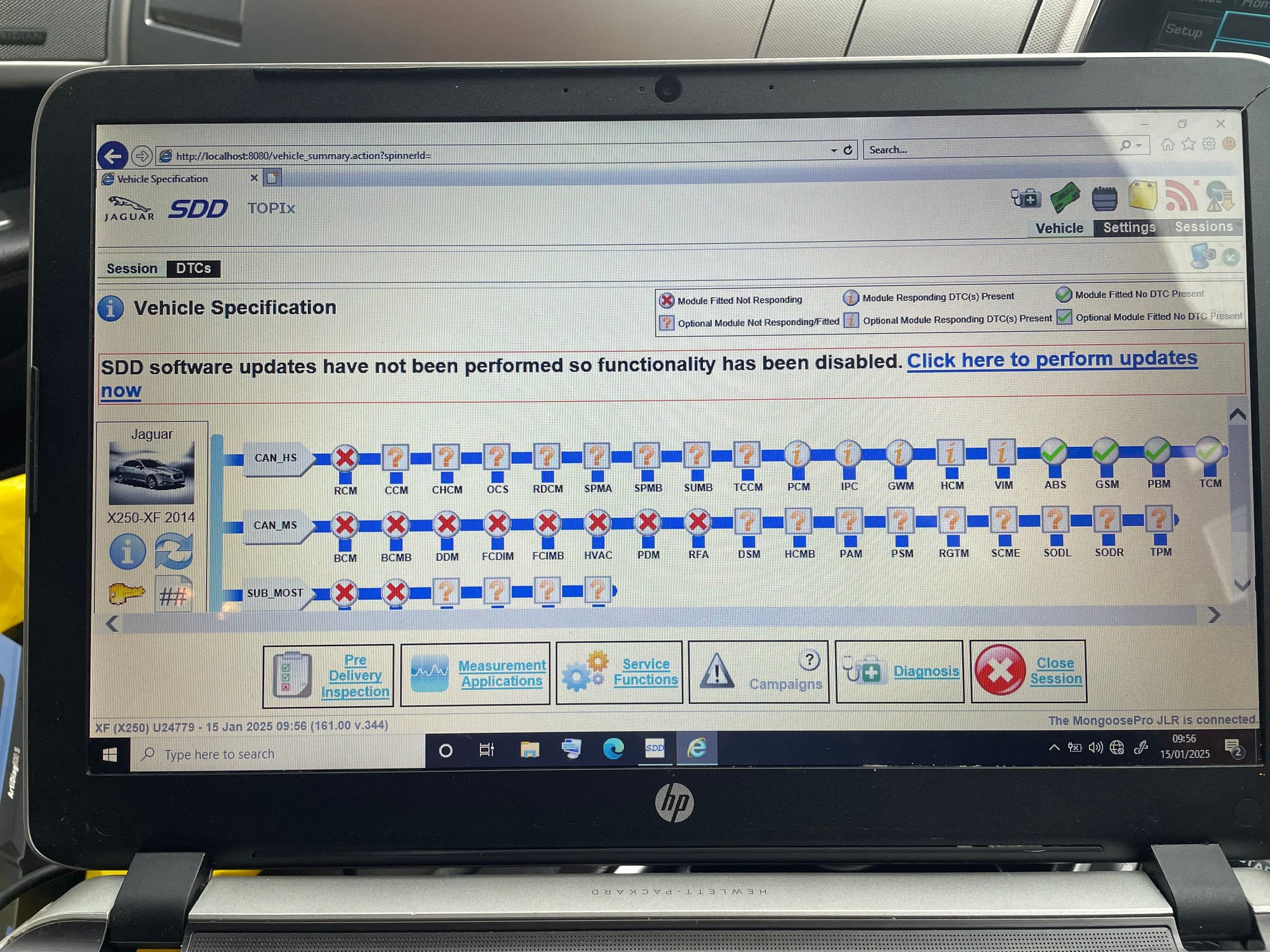

try going into Factory reset in the SDD And make sure you have a maintainer on the battery ,in the to right it shoud show green that a maintainer is on the go before any actions , also did you do the battery replace in the SDD

Thanks for the reply I’m new to sdd where do you go to do factory reset and no iv not done the battery reset

Done battery reset on both batteries it starts but soon the airbag light comes on and check pedestrian system it cuts out anyone know how to do a full car reset with sdd
