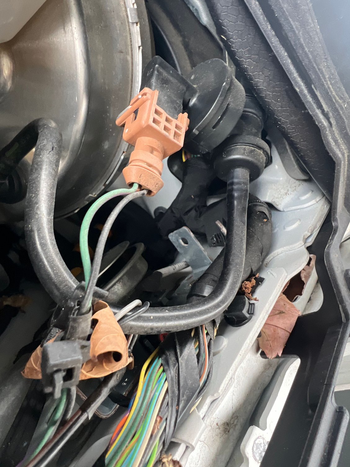

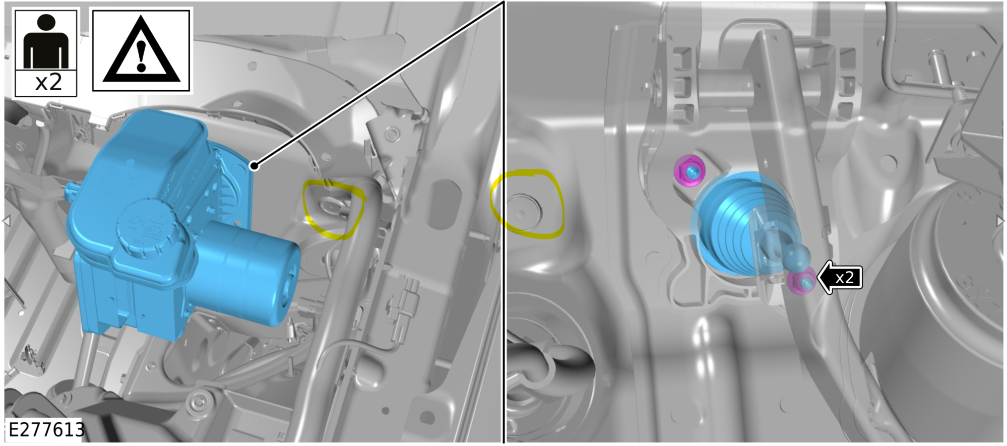

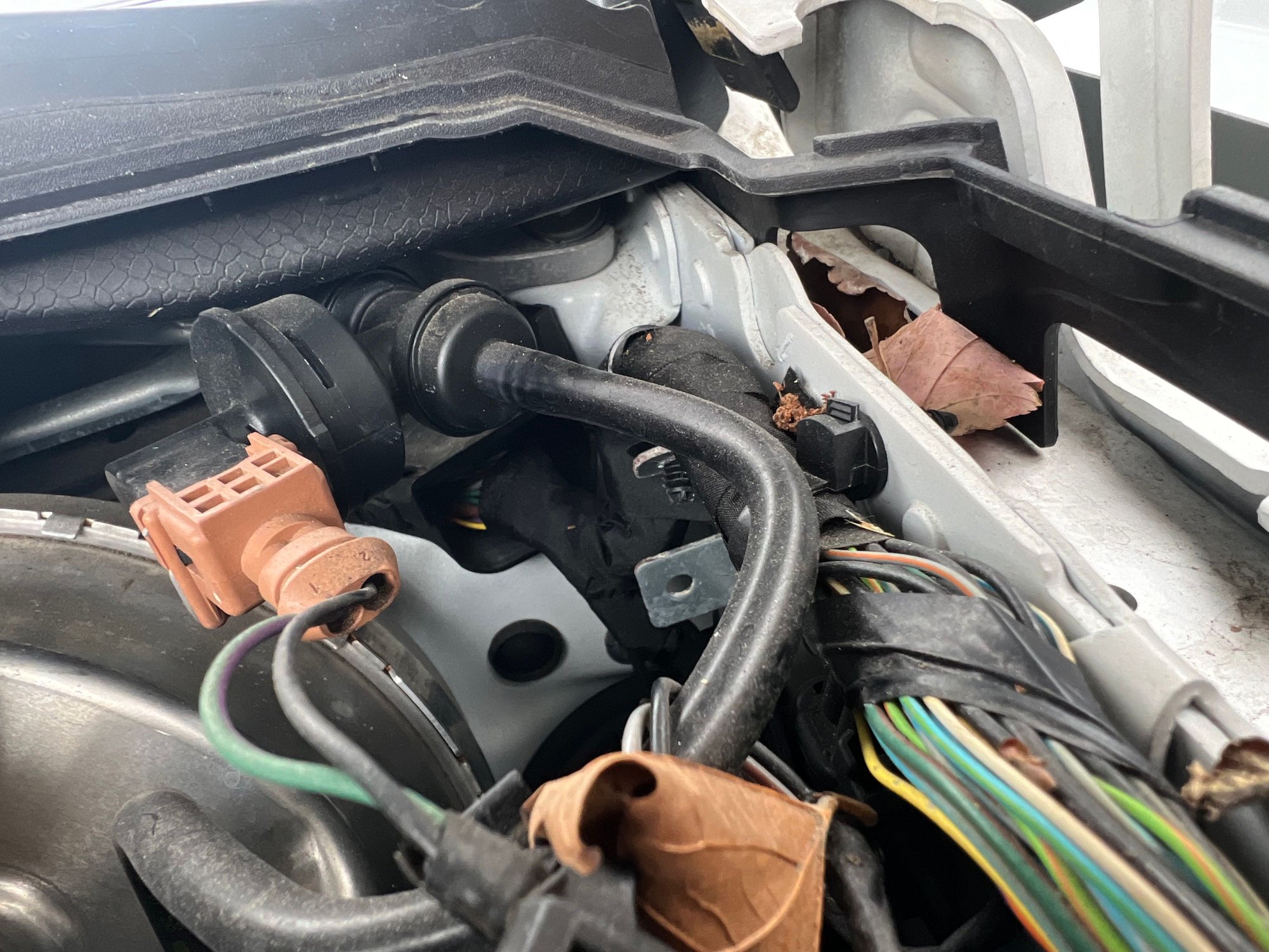

So I don't have a specific point on this car, but this image I pulled from Topix of the brake module, shows a plug that I circled next to it, from inside and outside of the car. When I run things for audio, nitrous kits, etc, I find things like this and use them to pass wires/cables/hoses though.
IMO that's the best option, look for a plug in the body in the area you want to go though, and punch a tiny hole in it, pull your wires through. If it's somewhere exposed to water running across it, you can seal it with rubber tape or silicone, but down in that area it should be safe anyway.
