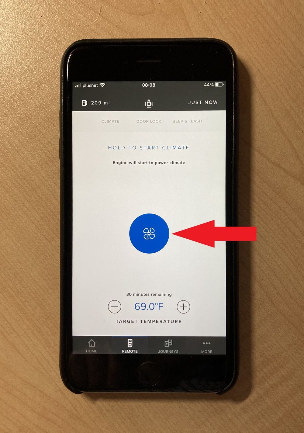

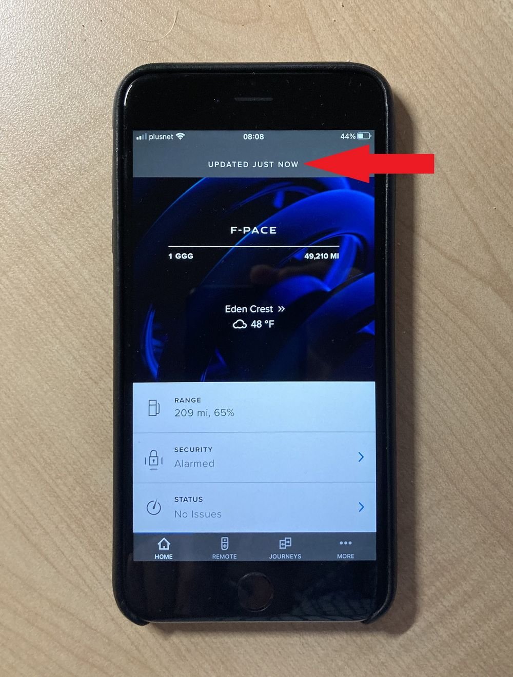

Old Dec 19, 2022 | 02:31 AM
1. is the vehicle definitely currently connected showing UPDATED JUST NOW?
2. after selecting REMOTE, are you TOUCHING and HOLDING the round blue button?
Temperature has taken a big jump in England this morning (48 deg F) after several days below freezing (it was 28 deg F yesterday) and I had used remote climate for the last few days. It can take around 30 seconds to communicate and start the vehicle and the button must be held throughout until it starts.
