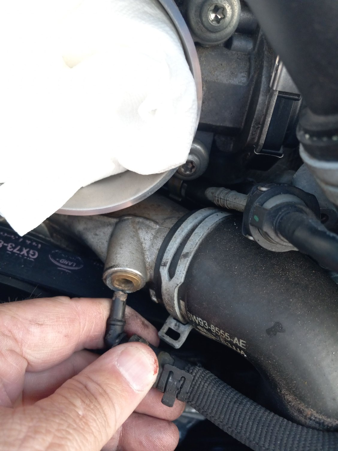

Hey guys. I am replacing my water pump on my 2015 XF 3.0. I found a broken off hose underneath that I need to identify. Can someone help me out? Lol

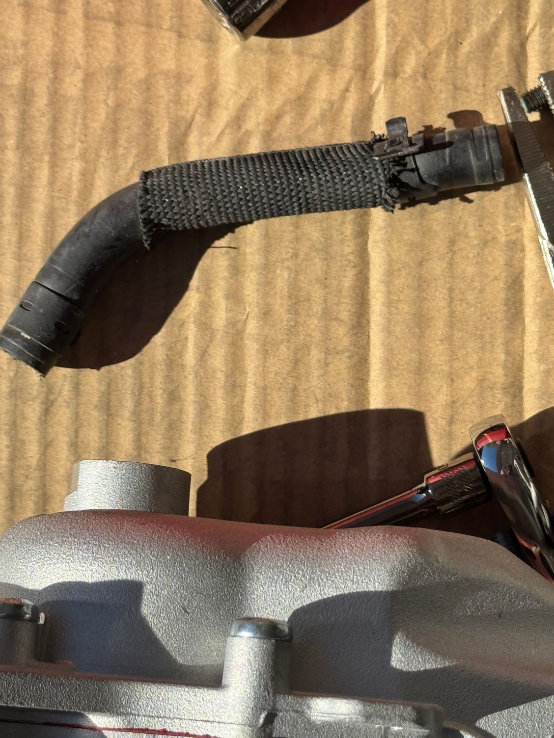

It looks like the one from thermostat housing to front of water pump with that crazy plug that is prone to break.
Don't pull on it or it will snap on both ends.

Metal replacement here https://www.ebay.com/itm/235598135377
