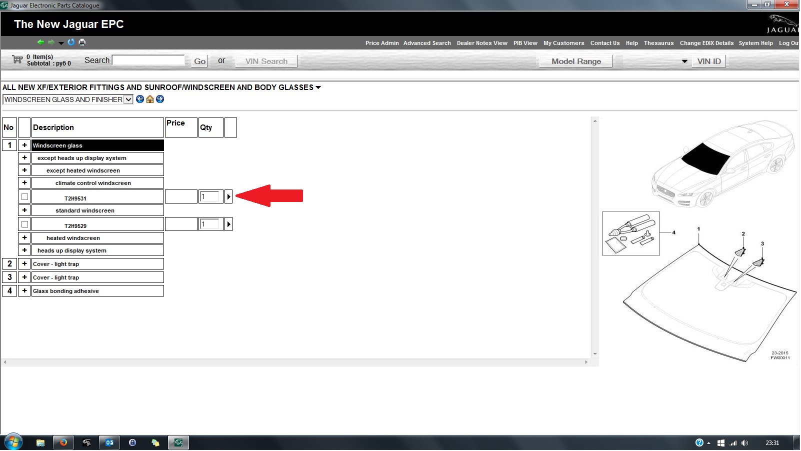

The XF is available with Standard, Heated or Climate Control windscreens for both normal and heads up display versions:
If your vehicle is fitted with the Climate Control option then it will most likely block the GPS signal.

I don't think a heated windscreen will affect GPS reception. It certainly didn't in either my X308 or XK8 which were both fitted with heated screens. My current XK doesn't have one and I do miss this feature in our UK climate.

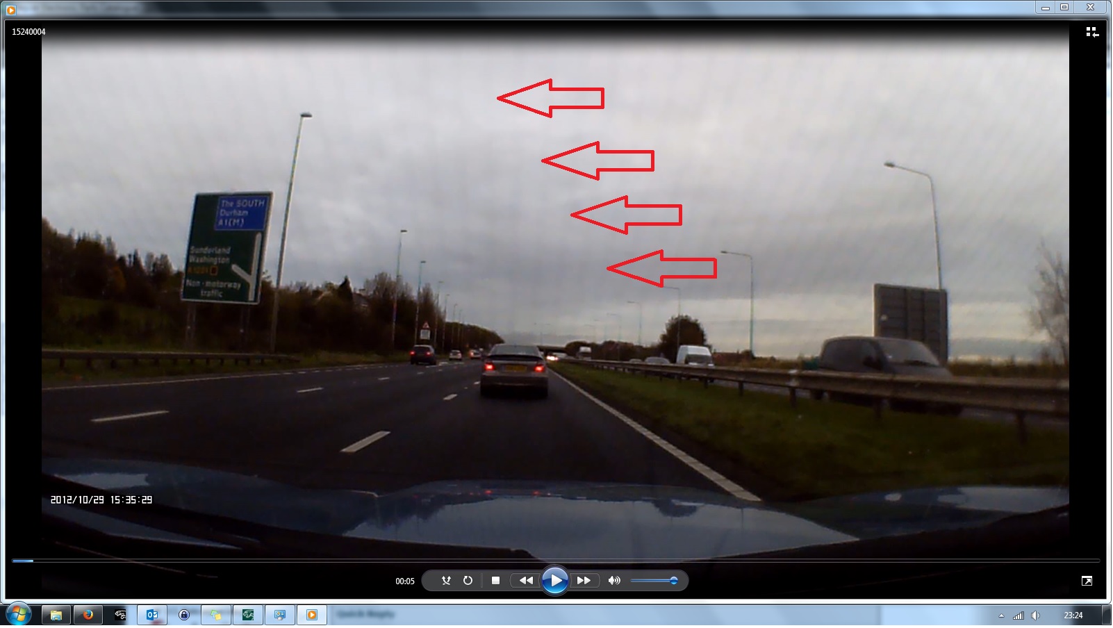

The fine wires in heated windscreen do annoy some people. They are exceptionally difficult to photograph but can be seen in this one taken on a dull day in my XK8:
Climate control is a UV filtering interlayer in the laminate which does block signals. Some manufacturers do leave a clear area next to the rear view mirror to allow the use of GPS devices.
