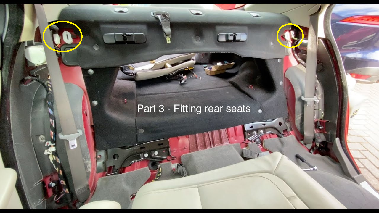

Ah found the photos, they were in a PM to someone else who was retrofitting:
Note you DO NOT have to remove the entire rear seat, the white plastic circled in yellow is a clip you can reach in and release with your fingers, to remove the bolster.
