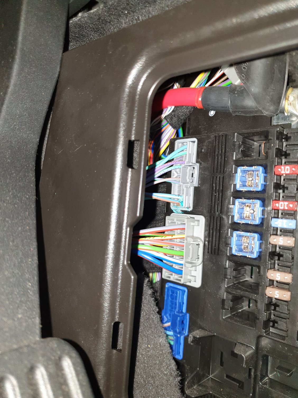

just received a xf at unit with failed mot due to main beam.and dip not working, chased it to corrosion on drivers footwell fuse box,1 connection has green/blue residue. Cleaned off and made sure dry, then all lights work.
poured a bucket of water into corner behind splash tray,nothing came into.car..tried screen wash pumps working nothing coming into car.
