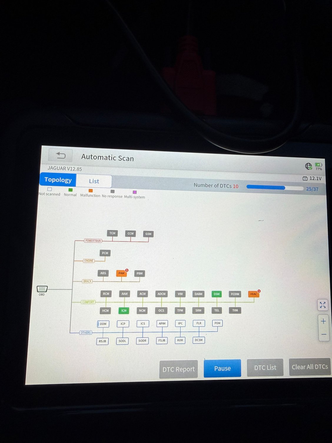

Hey everyone my name is meeri and i recently purchased a 2009 jaguar xf 4.2 supercharged
when i try to start the car all the lights turn on but no crank no start and no click, when i placed it on my scanner i noticed it has no communication with almost any module. i don’t know the
cars history and what has been replaced but can anyone help with what’s going one

12.1V is essentially dead battery

Dead enough to cause no communication with all modules, its 12.1 plus a booster pack on it.
