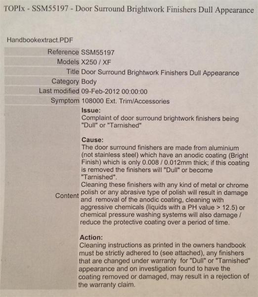

I am getting my trim replaced under warranty later this week. The dealer tried to buff it, and they were successful in improving the finish, but it became clear that they might hurt the car and it's just better to replace it.
So, to answer everyone's question: It is aluminum (not stainless, not plastic) that is anodized. See attached to confirm from the horses mouth.
Also, notice how Jaguar will get themselves out of the warranty if you try to fix it yourself. So don't do that unless you are out of warranty.
My service adviser said it's about $600 in parts to do both sides.

Whatever the material is, it is very hard and does not respond in any meaningful way to any liquid product I have tried. I have tried various polishes, rubbing compounds and Bar Keepers Friend. Nothing touches it.
ScotchBrite pads will get the stains off but then you can't get the cut lines out. I know there are metal polishing firms out there who could deal with it but you must take the trim off the car. One kink or dent in the removal process and you just bought yourself new trim anyway.
Replacing the trim, warrant or no, is a short term solution as the staining will be back soon enough. Can it really be this hopeless?

Does anybody else find it troubling that instead of putting out a bulletin on how to fix the problem Jaguar puts out a communication on how to disallow a warranty claim.
As much as I have loved these cars over the years I still wonder how they get away with some of the "stuff' they do. Cases in point, XJ notorious air shock F---up and this aluminium trim business. Everybody in the supply chain is aware of the issues but the head office crafts policies and procedures to avoid doing anything about it.
BTW -the trim staining on my car has returned after the first wash. The metal polish did not fix it.
