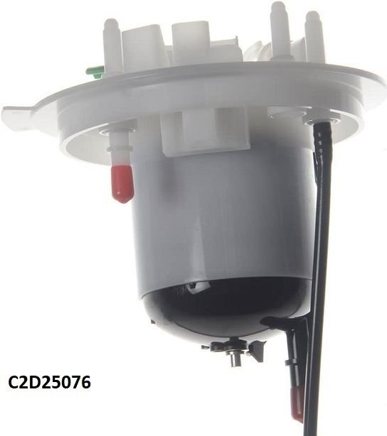

The fuel filter was NOT deleted! Any Jaguar dealer who states that is clueless.
It's mounted in the fuel tank and according to Jaguar does not need replacing which I find laughable!
Here is what it looks like;
Close up with part number.
I have one on my bench but have not swapped it out yet. I have not found anyone who has?

Thanks Clubairth, I’ll checkout the part number.
