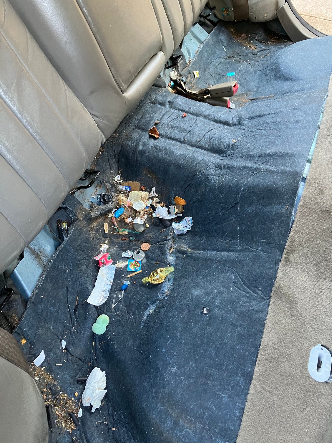

I did find $1.37 in change under the back seat:

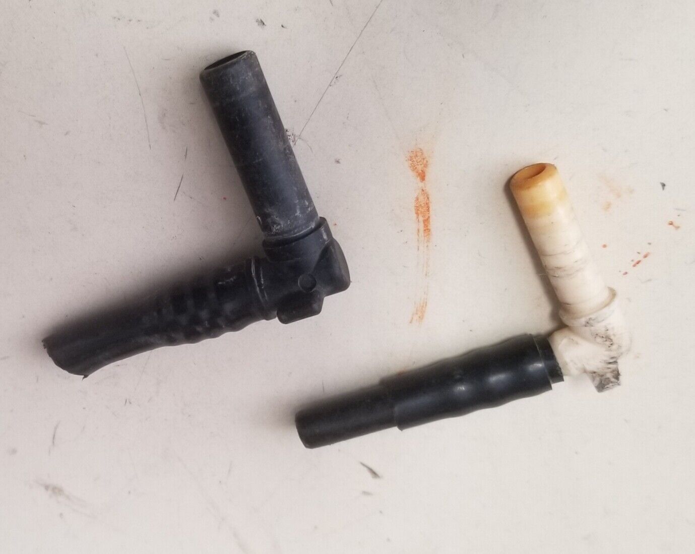

Okay, only partial success, but am making progress. Followed the directions to break off those miserable collars and I pressed down directly on the sleeve. Piece of cake. Worked like a charm. Wish I knew about that trick yesterday.
Now to figure out how to replace the elbows. Discovered tool marks well below the damage I caused yesterday. Looks like somebody else was in there before I got the car and ran into similar trouble. It appears they got the tube out about 1/4” before it jammed like Chinese finger cuffs.
More details and pics to follow later. Got to take advantage of the daylight while I can.

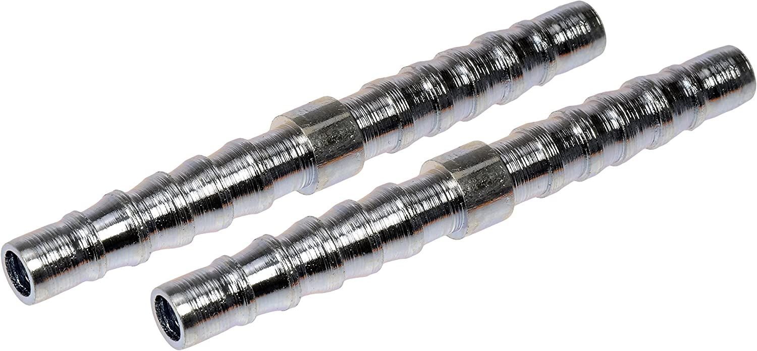

That's great advice! While the blower fan in my heat gun seems to disipate fuel vapors without igniting them (so far anyway!), you're absolutely right that it's much better to be safe than incinerated or disintegrated!
Another solution I should have thought to mention is the Dorman fuel line unions, which don't require any heat, just nice square cuts on the ends of the Nylon lines. They make them for 5/16" and 3/8" lines and possibly other sizes:
Dorman Union for 5/16 Dorman Union for 5/16" Nylon Fuel Lines

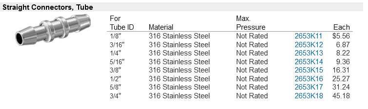

Dorman also makes fuel line hose barbs similar to the ones I have gotten from McMaster-Carr:
Dorman 5/16 Dorman 5/16" Nylon Fuel Line Barbed Connectors

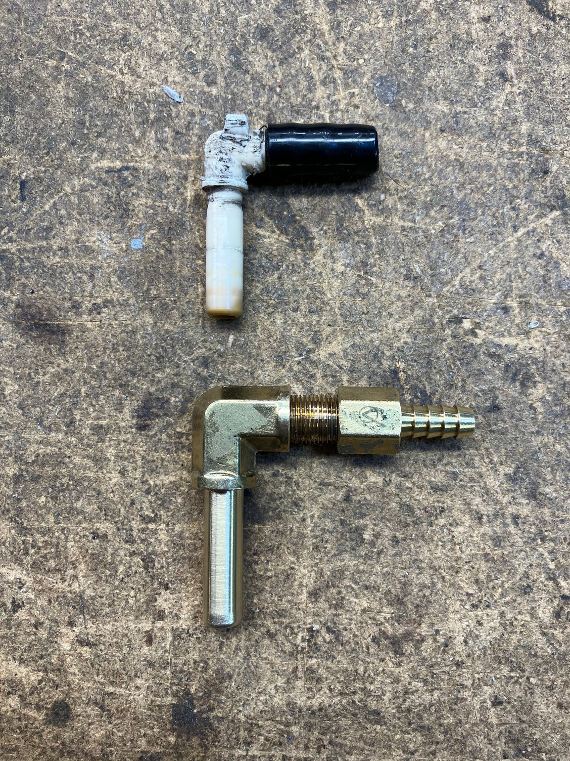

I did fabricate a simple plate of 1/8” Masonite to cover the tank opening. It’s just a 5-1/2” circle secured by the locking ring. This has made things a little safer, although fumes are likely still present in the lines.
Here’s one of the new fittings I made. The part that plugs into the pump module has the same dimensions. I made the part longer with the barbed fitting to compensate for where I cut the plastic line. Try as I might, I couldn’t release the damaged fittings from the plastic lines:
I soldered the threaded connections to ensure no leaks.
Any thoughts on how to get the barbed fittings pressed into the plastic lines? My current plan is to heat up this hose fid in boiling water, and then quickly insert it into the tube. I also plan to have a rag wrapped around the outside and pour boiling water on it. In theory, this should heat and soften the tube from inside and out. I don’t know if I should try to expand the tubing with the fid. I’m mostly planning to use it to heat the tubing:
I'll preheat the barbed brass fitting before assembly. I can do that away from the car, using the heat gun.
I also plan to install a constant tension hose clamp over the barbed connection.
