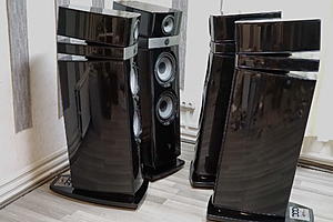

Regarding Focals, great speakers, I have this brand In my studio(see pics) - 2 pairs of Focal Maestro Utopia and Scala V2. those are 100 000EUR+ that is already expensive. 2000EUR is nothing to put in to car audio if this would gelf improove sound. but short answer is that it will NOT (at least easy way) I have also hughe collection of Focal Utopia raw speakers anything from berylium tweeters to 15 inch W cone subs. probably 40psc or so. I could fits all them to my car, but I wont. Because I will not make sound MUCH better unless I will spent SIGNIFICANT time for system tune. Which then coverts to nearly same price as original B&W system, which probbably in 2007 costed anywhere from 15 to 40 000EUR for Jag to hire B&W engineer design this system.

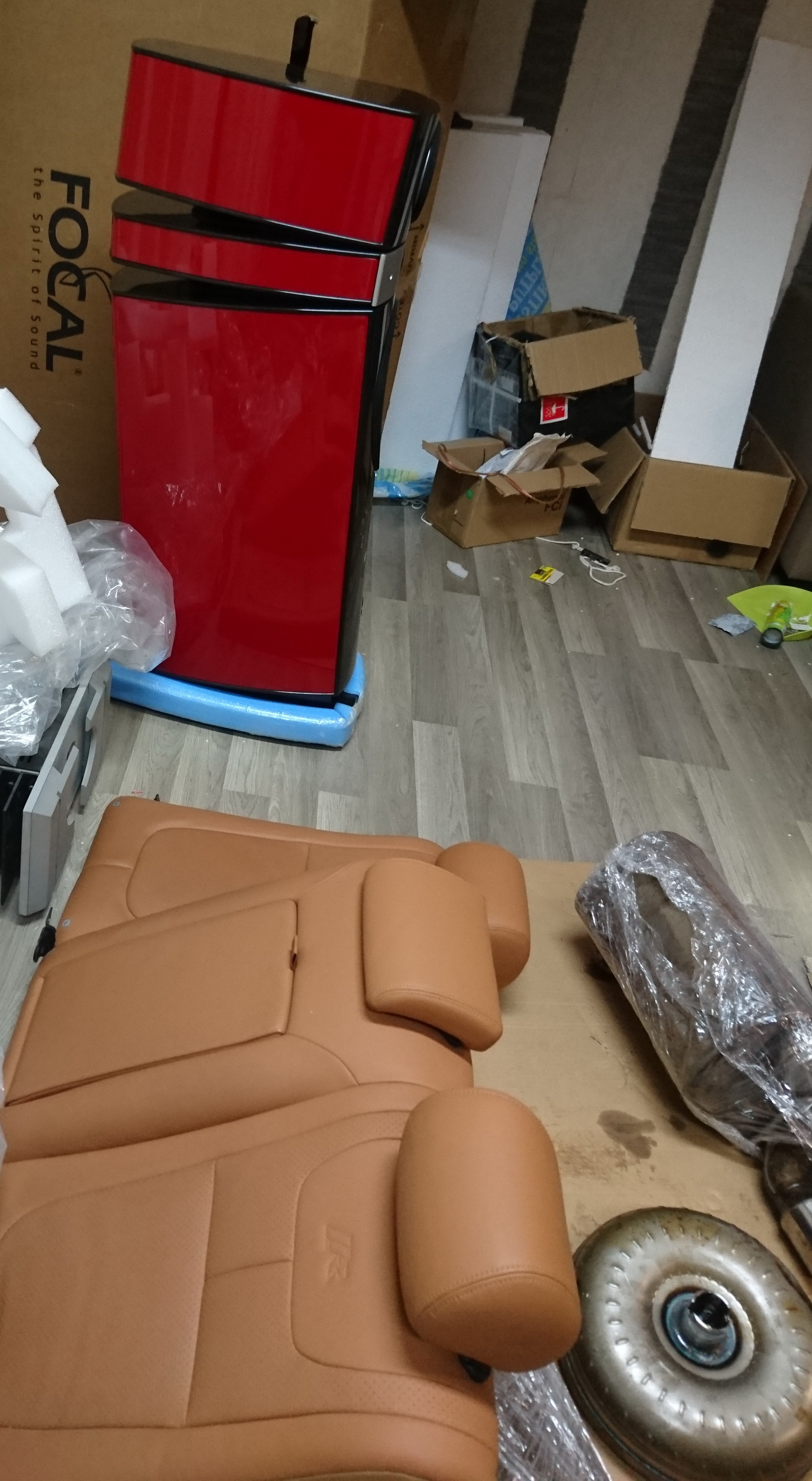

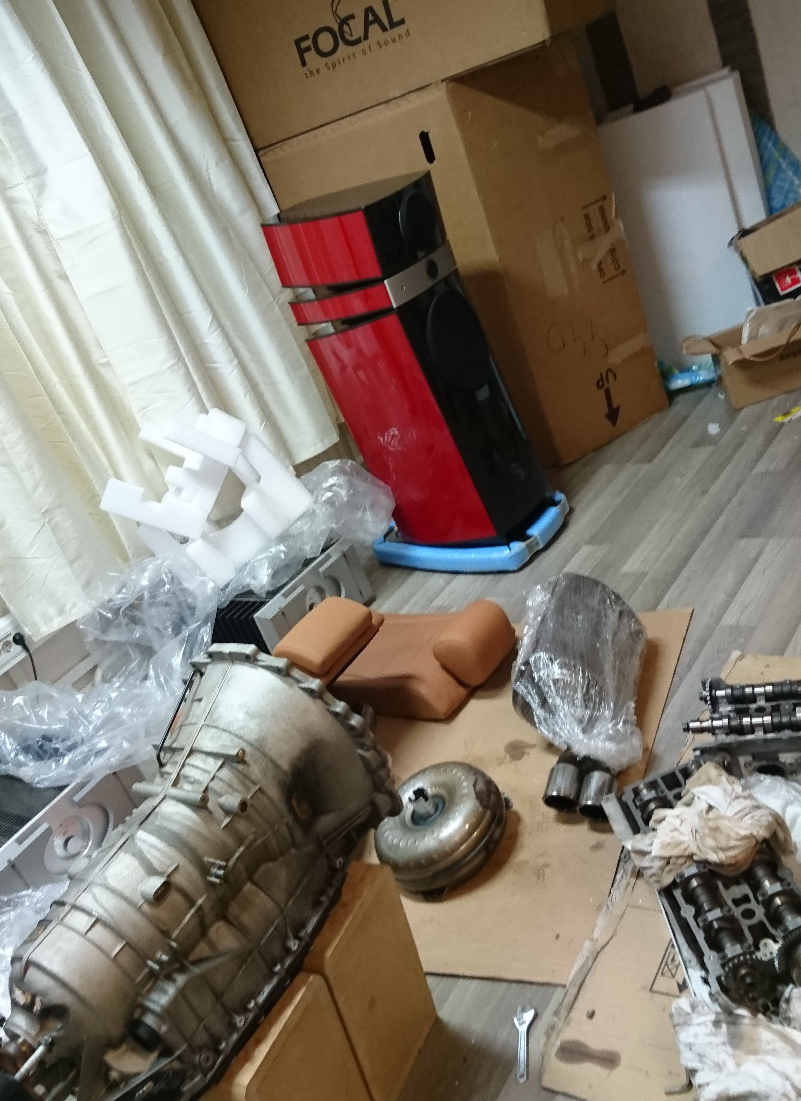

Ant to finish on the more brigther note- se pics what happened when home audio guy decided to do car upgrade in studio- need to be closed for a 3 weeks

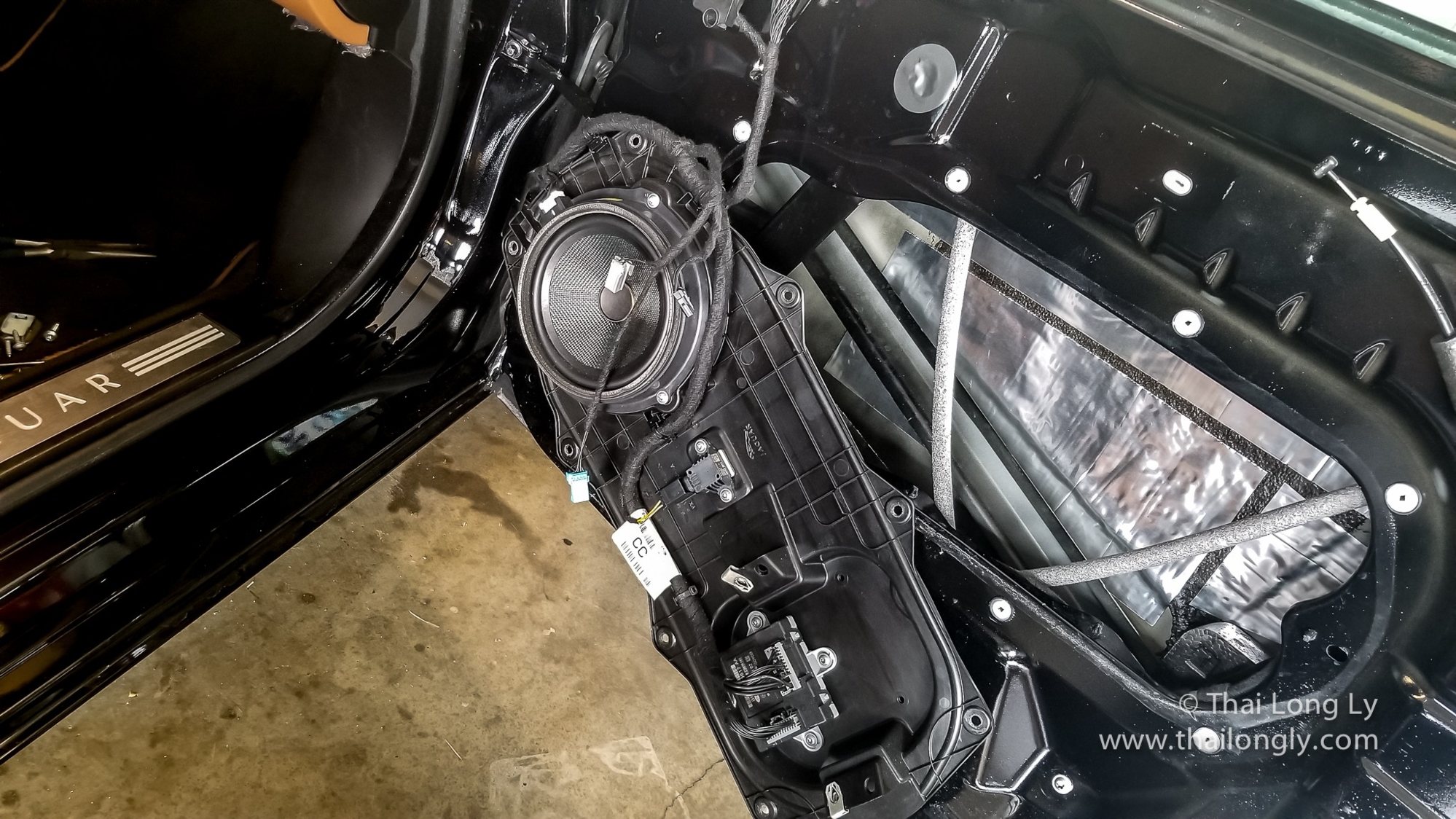

Here's a picture from when I was chasing down a rattle when I first got the car. Upon closer inspection, the dust cap looks completely different than that of a B&W driver. Although the carbon weave looks similar, I'm not convinced this is a B&W branded driver, despite the badging all over the car. If anyone knows what this driver is that would save me a tearing apart the door once again just to look at the basket for any markings. Thanks in advance.

the diferencies not in cone colour only- magnet system is neodymium not ferrite. i had both systems bower wilkins 2008-2011 and 2012. all drivers are diferent not only bass drivers.

Thanks for the clarification. I just learned that they updated the drivers for the 2012 MY and that coaxial speakers were used as well. Neodymium is preferred, so I'm glad to know that's what is being used. I'm happy with the way they sound and am now interested in upgrading the 8" sub to an aftermarket driver with a beefier voice coil, using the stock location. Hopefully that'll give me a bit more support on material that's not extremely well mixed.
