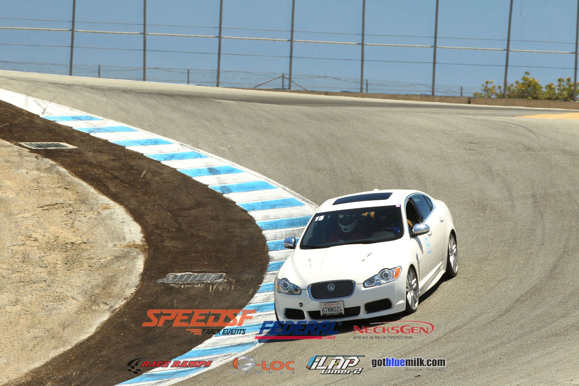

Well I did it and very glad I did. Car performed great and no Miata's passed me. However, one thing did cut my day short and it was my aftermarket brakes, that I thought were an upgrade over OEM. they were not. I had installed R1 slotted and drilled rotors and EBC Red Ceramic pads. At the time primarily for looks and less dust. I thought they would be fine, they were not. During third run felt significant vibration when applying breaks. Instructor happened to be in my car, who is a service technician at BMW, so somewhat knowledgeable. Anyway decided not to push it and ended after 2 1/2 sessions. Driving back home no issues, although they do not seem to stop as quickly. I may have them checked out. With these heavy cars, brakes take a beating and a bit disappointed at my "upgraded" brakes. I drove at the R academy back in 2012 and the stock brakes performed flawlessly all day long, with no fade or issue whatsoever.
Anyway very happy I did it. Had an M5 in my group, also a first timer, and was leaving him behind in my last run before brakes gave out. BTW - his day ended early as well, he got one wheel off the course and when coming back on nicked the sidewall and began to leak. No doubt cars take a beating but what other chance do you have to run these cars full out. Great fun, would highly recommend the experience. Thanks everyone for your input and counsel. Very much appreciated.
Famous Corkscrew at LS

Thanks for sharing your experience! Love the pictures and sounds like a wonderful experience. Curious what the day costs (not including new brakes )

Yep, would have to concur with that. However, I think it was my rotors which did not stand up. I think with the extreme heat they warped a bit and when cooled down they thankfully returned to original. Sad because these were the top of the line slotted and drilled hardened rotors from R1 Concepts.
