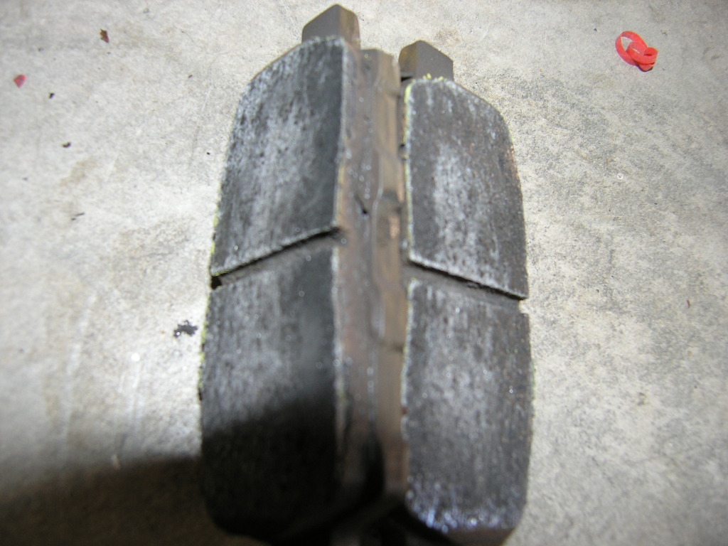

I tried EBC red stuff on my G35 Sedan that attended a few track events. Everything you say about street performace was spot on however,...
At the track these pads did not cut it after three 15 min races spaced through out the day the pads had cooked and deposited pad material all over the rotors. They are a good street pad but not up to track duty.
Below are some pictures the red paint cooked off almost completely. The pad material had air filled hardened bubbles on the edges.
What I found would hold up to a track day and was cheaper then any of the other 'performance' pads were Posi Quiet Ceramic pads they also produced zero dust. They did sqeak really bad when they were cold but for the performace I didn't care. I just checked the website and they do not offer ceramic's for the XF :-( I emailed them and asked if they will start.
