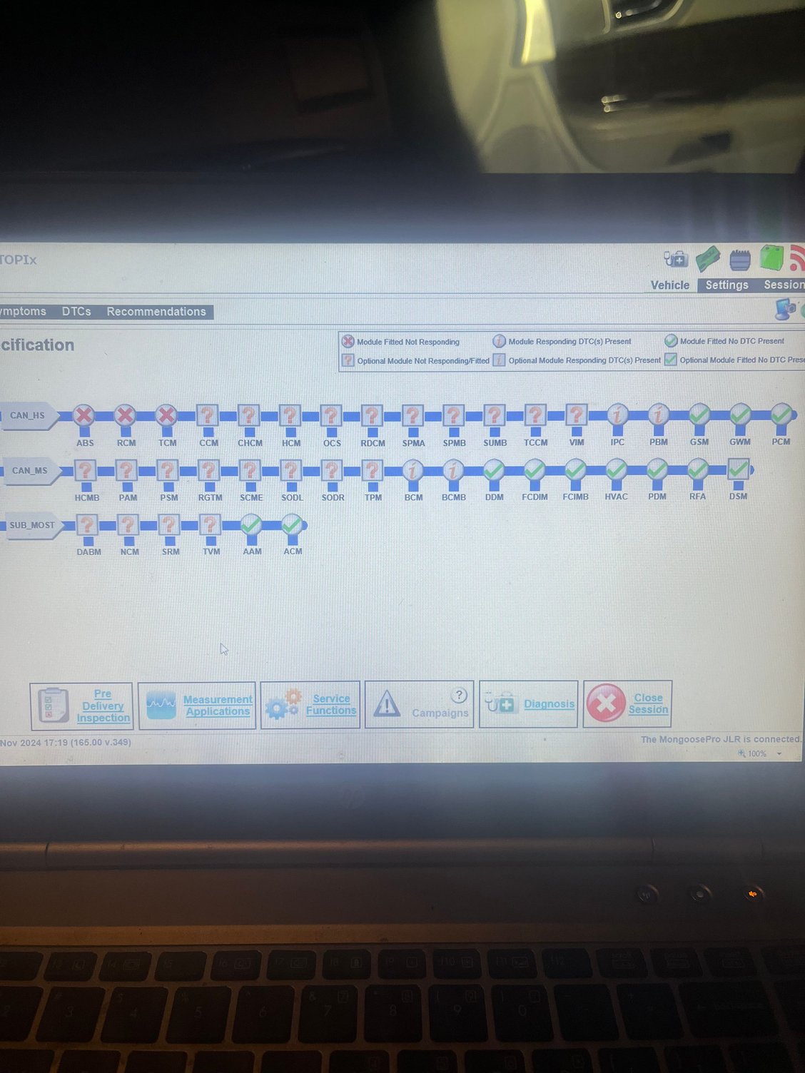

Battery went dead in car. Now smart key not recognized. I used diagnostics with sdd. Picture is below or attached of the readings. What do you make of it?
please help
please help

COPIED FROM FB....
Jaguar XF remote lock/key not recognised issues.
I've been getting many requests from the group via word of mouth and I've done quite a few.
Issue one most common:
Car won't lock after battery disconnect. This is solved via immobilisation in SDD.
Issue two less common:
Key not recognised at all hence no ignition, immobilisation not possible.
This is done via cluster reprogram as it will bypass the key sequence, turns ignition itself and do the immobilisation at the end.
This will also update cluster to latest software, bonus.
Please don't throw suitcases of money on KVM module/keys and what not, I've never seen a faulty KVM module.

My problem is that i try to cluster reprogram but it does not run all the way through. it says secure access not acheived.
